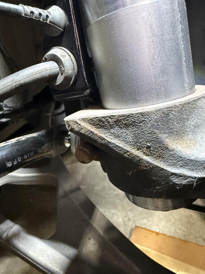

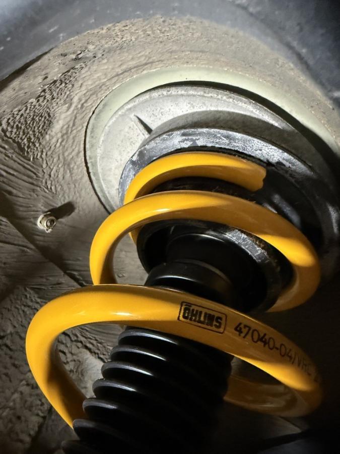

              It looks like the spring is compressing about an inch under load, it's a little tough to measure on the ground. from the setup manual, it's asking for 196mm spring length with preload, which is 7.7''. I'm measuring somewhere around a 6.5'' weighted length, and that's with the front of the car sitting about 1'' higher than the rear.
              I also verified the stamped PN on the spring matches what's in the manual, so it should be the correct rate.
              I was going to ask Barry, but I also figured the simplest answer is the most likely, which is that I did something wrong. This is really strange to admit, but even after over 20yrs of owning 7 BMWs, this is the first time I've messed with a spring/strut assembly.
                #37
                that strut looks not fully seated at the base.
                IIRC the Ohlins have a welded on tab that should bottom out against the clamshell when fully seated.

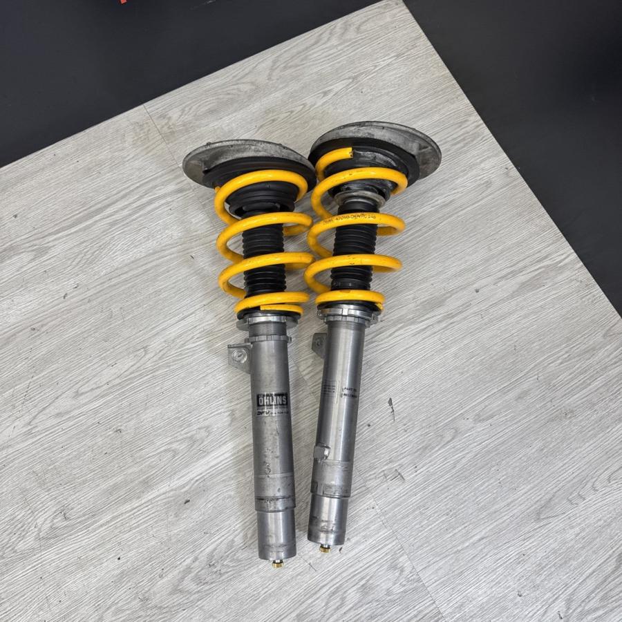

                  You can see the tab in this picture:

                    oh shit. that'd do it.
                    I have it in there where the recessed portion sits inside the kingpin. that's like 3-4'' of ride height right there.
                    As I suspected, the simplest answer - that I'm an idiot - is the most likely. 😳
