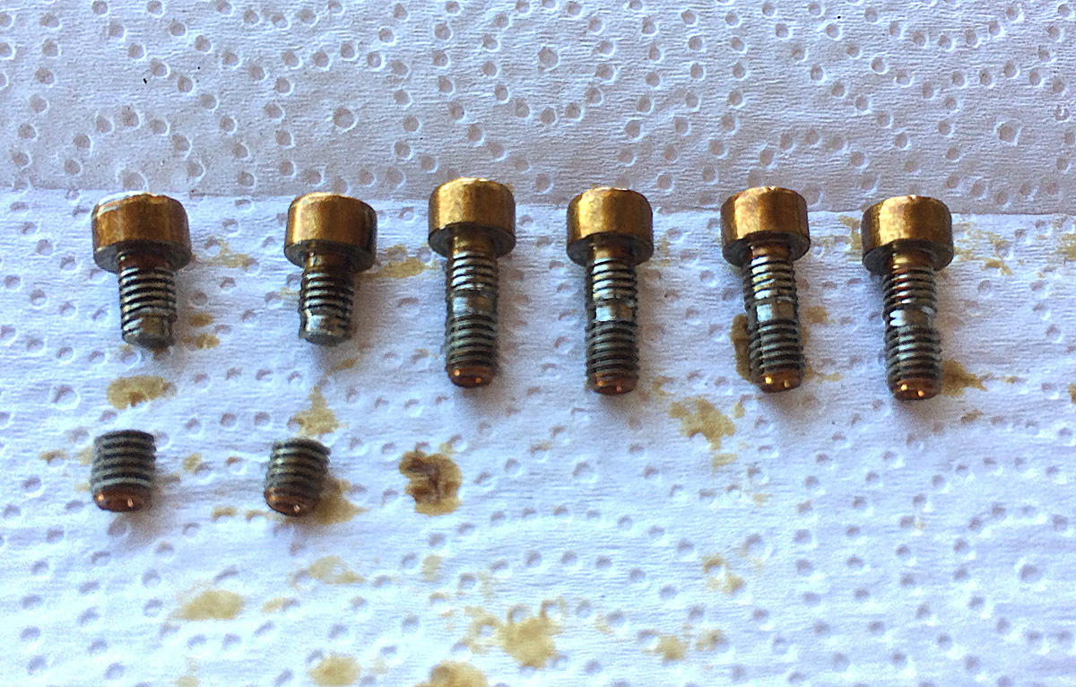

        Wouldn't be these little buggers would it? Mine sounded similar and got progressively worse until I overhauled the Vanos.
          Fortunately, no. I upgraded to the Lang bolts w/ red loctite when I did the Beisan seals and oil pump disc a few years ago.
