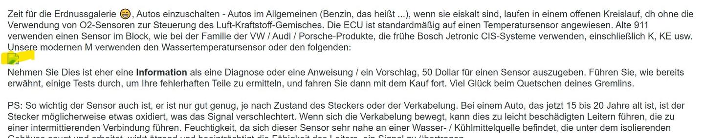

          Time for the peanut gallery 😁 to chime in - cars in general (gasoline ones that is...) when they are stone cold, they run in an open loop, meaning without the use of O2 sensors to govern the air-fuel mixture. The ECU relies on a temperature sensor to default to closed or open loop. Old 911s use a sensor in the block, as with the family of VW/Audi/Porsche products that use early Bosch Jetronic CIS systems, which include K, KE, etc. Our modern M’s use the water temp sensor, or this below:
          Click image for larger version  Name:	1CDEFC45-87A3-4F3D-A3E3-CEA7112C0F87.jpeg Views:	0 Size:	213.3 KB ID:	47697
          Take this as information rather than a diagnosis or an instruction/suggestion to spend $50 bucks on a sensor. Like others stated, do some testing to determine your faulty part(s), then proceed to buy. Good luck squashing your gremlin.

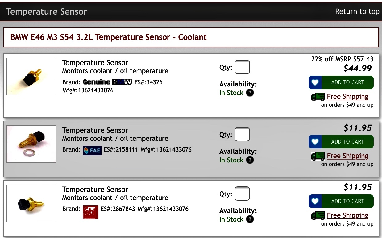

          Monday fun-day where I chime in again, from ECS’s site, temp sensors can be had for the cost of an In N Out double-double combo meal Including animal fries w/extra grilled onions. That seems fairly inexpensive. The original image got deleted somehow, so I am just re-posting the same info.

Name:	Anmerkung 2020-08-03 085948.jpg
            Thanks for the plausible explanation :-) What does yellow mean? Thanks

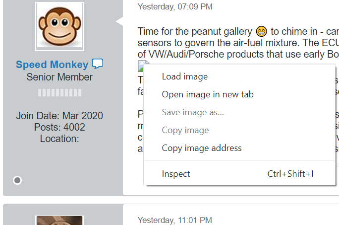

              That yellow looks like an image that didn't load. If you put your cursor on it and right click...

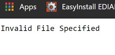

Name:	Anmerkung 2020-08-03 200853.jpg
                I tried that, it doesn't work!

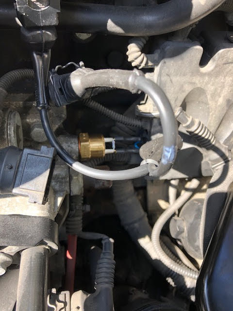

                        Click image for larger version  Name:	IMG_2917.jpg Views:	0 Size:	75.4 KB ID:	47774
                        https://www.probsten-tech.de/z4mm3-s...ruckelloesung/
                        The right solution would of course be a software update, unfortunately, I don't have the options!
