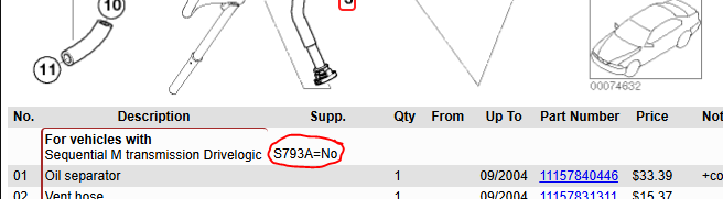

    I'm not sure how RealOEM works out whether the car is manual or SMG. Obviously if you put the last 7 digits in then it can work it out but from just choosing the series, body type, model and whether it is LHD or RHD doesn't seem to cover it.
    It doesn't. There are two different diagram pages that you can open, one for SMG and one for manual.

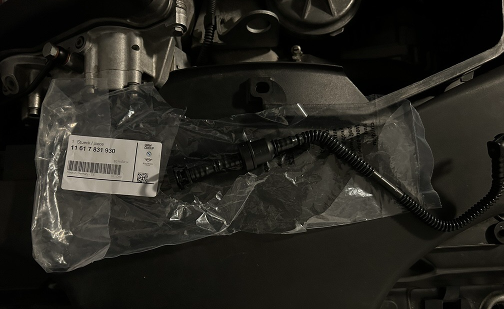

        I don't think there is a check valve on my car. There is definitely not a valve in part 11 61 7 831 336 in post 71 but there looks like there is a valve in my engine bay pic, post 61.
        I select based on production year at the door sill, although mine is a 2002 model, my production year is 2001 / 11

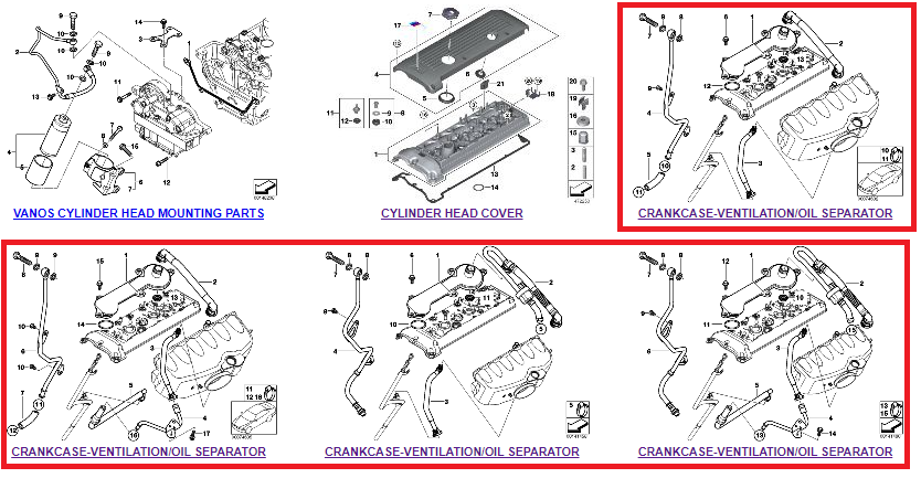

        In RealOEM, they post both SMG and Manual parts together lik all 4 these options
        You need to be very careful to browse what's inside and with the word here: SMG Yes and SMG No
        I didn't check what's in my vehicle at the moment, but I am confident that mine is a manual since from factory, and has never been converted or anything.

          Thanks. It was because i was putting in the VIN, i only had one 'Crankcase-Ventilation Separator' section shown. I'm impressed if you had 4 'Crankcase-Ventilation Separator' sections to choose from.

                    Thanks, after studying my engine bay photo for a while, the 11 61 7 831 930 is the hose fitted to my car.
                    I presume the fat piece in the pipe is an NRV valve.
