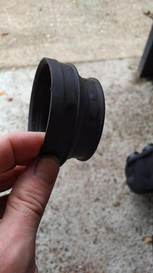

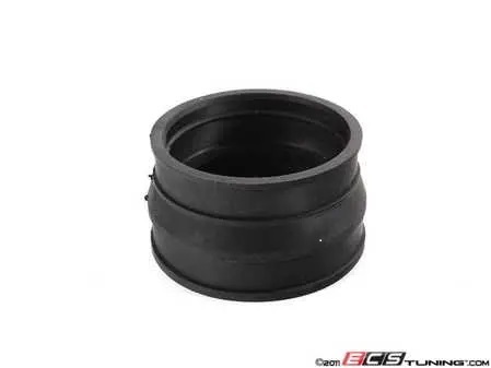

    Late build cars may need to replace the throttle body boots with the slim style found on early cars.
    Late style boots
    If yours has 'large' inlet boots you may need 6x of the following:
    - Throttle Body Boot - BMW P/N: 11617830265
    To add, both the CSL Air Shut Off Valve and the CSL Crankcase Hose can be adapted from the stock ones with appropriately fitting vacuum hoses. I did this for the air shut off valve and that requires 8mm ID tubing. Can't comment on the size required for the crankcase hose, as I bought that part new.
    Also, the boot clamps on the throttle body side are reusable, but the ones on the airbox side are technically not. I say technically because you could pry them off and recrimp them once on the CSL box, but you could easily mess them up in the process.
