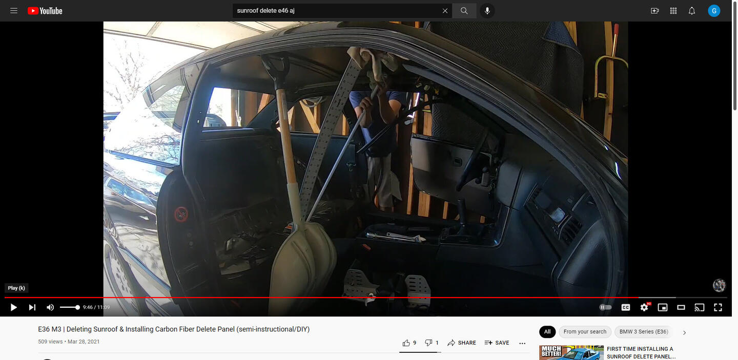

        #48
        If not sticks then shoves!!! Whatever works...
