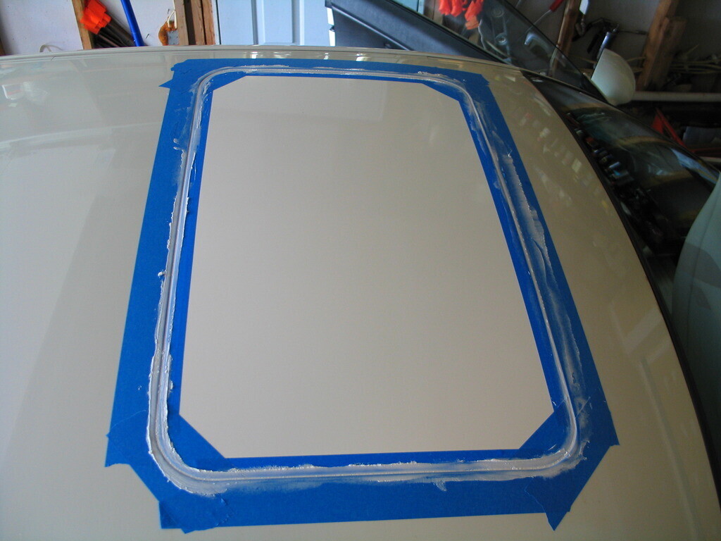

                        AJ hartman panel is perfect fit. The outside appearance is very dependent on the skill of the person applying the silicon sealant.
                          #42
                                This is how I approached it:
                                Then smoothed it with the edge of an old credit card.
