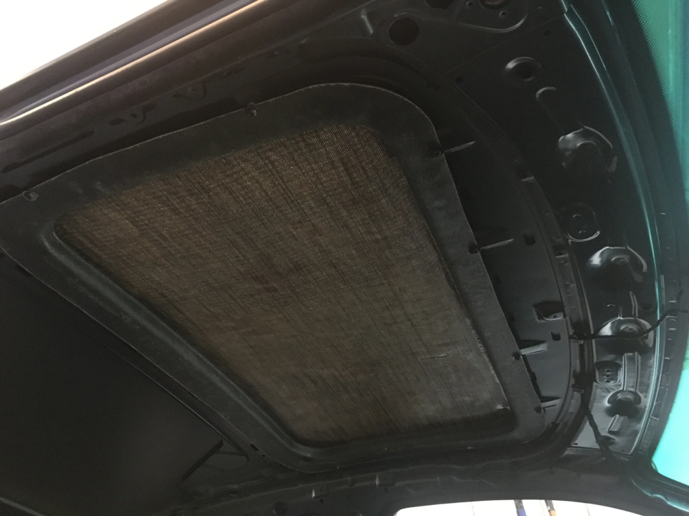

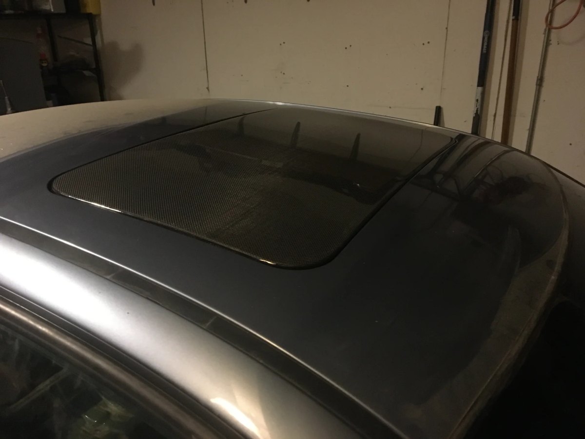

                  Call me sentimental, I love this panel. ​

                    Is that a gap between the panel and the opening? Looks massive or am I looking at it wrong?
                      #85
                      I had my lil girly inside, I'll ask her how level she was holding it. To be fair, I should have shared a picture with it fitted from the outside too.
