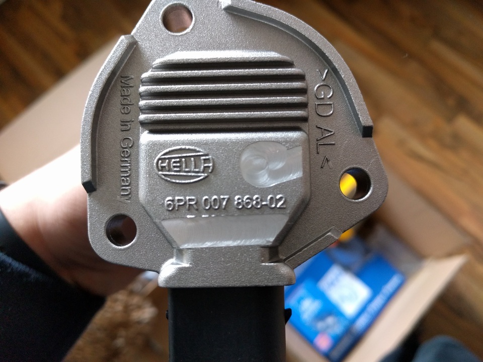

          Hella makes these for BMW. I’ve seen images of the Hella unit with the BMW logo ground off.
            yep hella is oe

                I love it when you see expensive parts, and the OE manufacturer simply grinds off the logo for the non-BMW branded part. That's a huge price difference too. Had the same thing with coils on my Toyota years ago. $100 each at the dealer. Local auto parts store pulled one off the shelf and it was identical with the toyota logo ground away, and 1/3 the price.

                      Wow, that's so cleanly done. I know with some of the plastic stuff, it looks like it's done by hand, but I can imagine rows upon rows of sensors mounted in some sort of jig, and a small endmill quickly zings off the logo.

                              Hella is the OEM.
                              See pic where the BMW logo and part number (12617508003) have been grounded off.
                              Remember to change the bolts also - 07119905400 x3.
