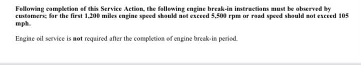

                I like how you’re approaching this! Using logic to see what makes most sense. So let’s ponder, do you think BMW supplied BMW “Rod Bearing Recall” break-in stickers different between months? Or was their probably only the one type produced? And does that one match what the SIB states in document.
                I’m just clarifying there doesn’t seem to be no WOT listing for the Rod Bearings. Not that it really matters lol. I’m just like the facts straight or confirmed. My burden when reading things. Sorry.
