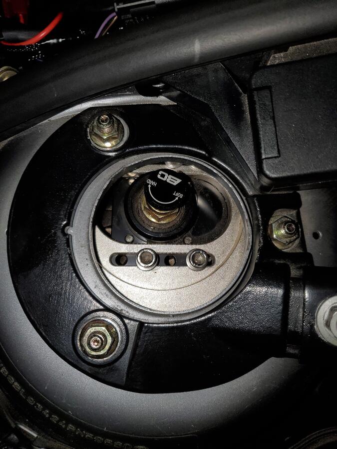

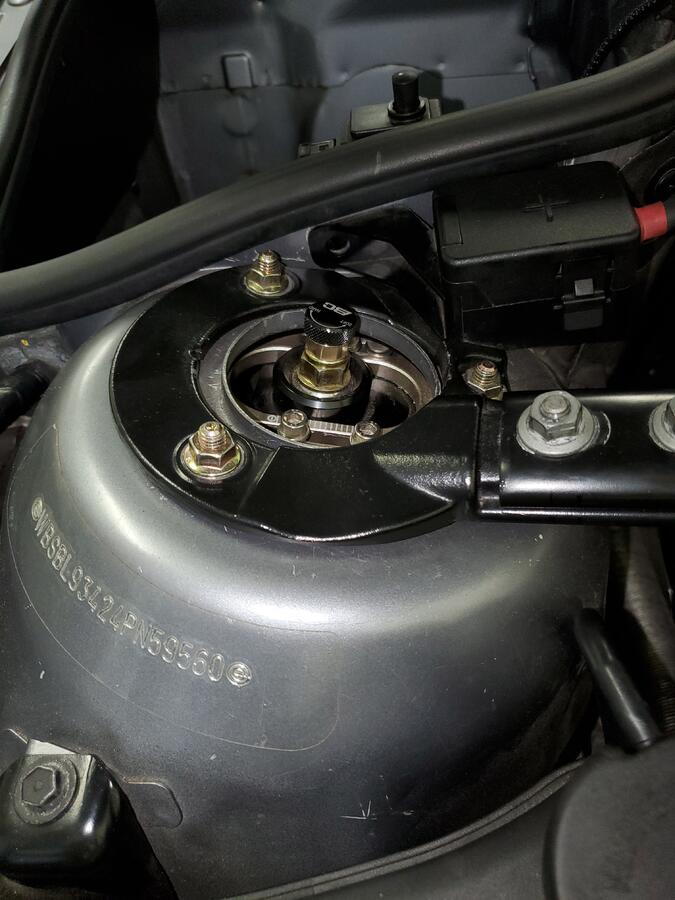

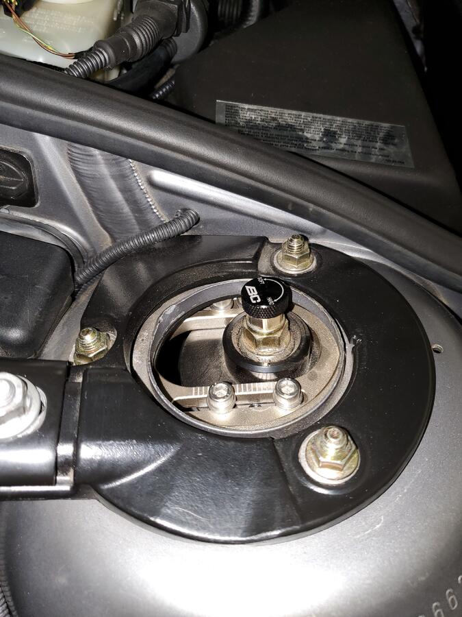

    The previous owner installed a set of BC coilovers and one side has significantly more camber set than the other for some strange reason.
    I would like to correct this but the top mounts have 4 allen head bolts for camber adjustments and only 2 of the 4 bolts are accessible with the offset style top mounts.
    Would it be a matter of removing the 3 nuts on the top side and then dropping the shock down a bit to gain access? I don't like how these are set up with camber plates yet they are not adjustable without taking things apart.

    The previous owner must have installed them wrong. All the bolts should be easily accessible. You’ll have to remove the coilovers and rotate it so that you can see all 4 bolts on the top.
      Previous owner screwed you up lol. You should be able to drop just the top and spin it the correct way though. Make sure to tell the PO he's a dummy.

                  What I meant to say was that you actually have to physically remove the coilovers to rotate the top to the proper position where you can see all 4 camber bolts. Sorry if I wasn’t clear.
                    I understand I have to remove the coils on the topside. I did this today and managed to get enough access to set the camber equally on both sides. But during that process with things apart I didn't see how I could spin the camber plates. They seem to only go in one way.

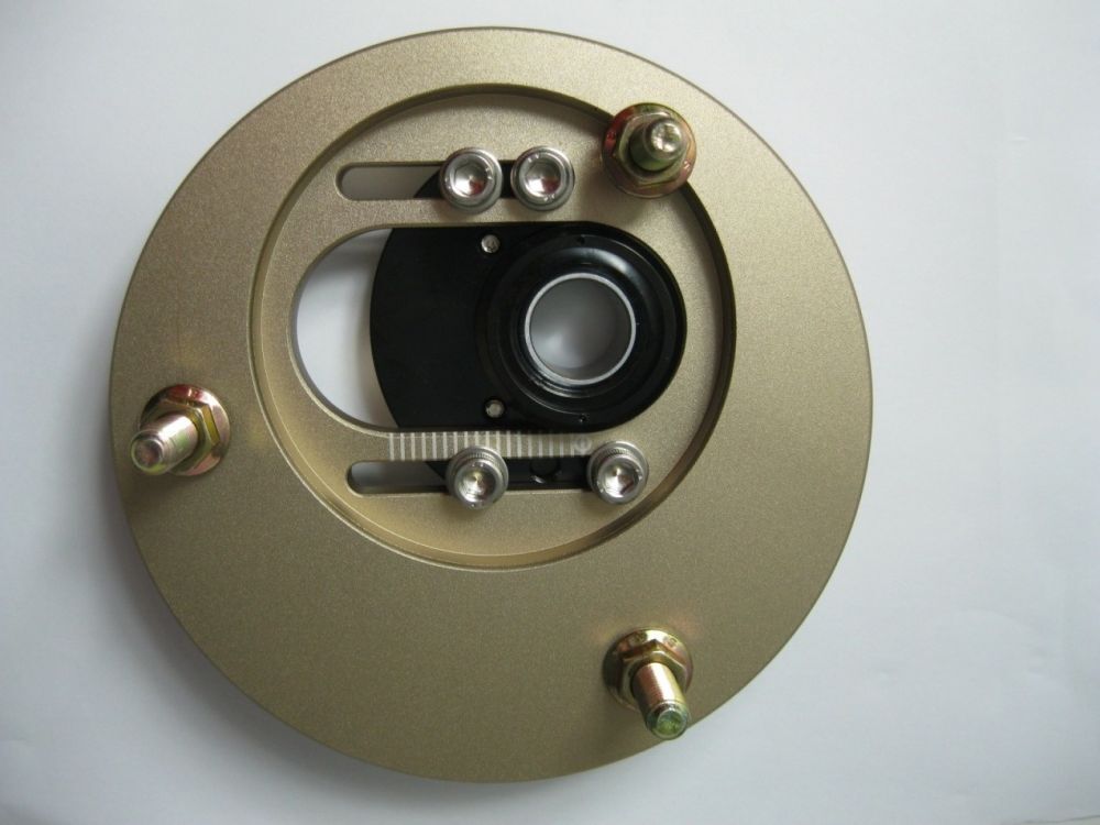

                        Offset camber plates offer more camber than standard camber plates, about 1 degree more I believe. Could be that PO got them for track purposes or stance.
                          I have the same BC coilovers with the offset camber plates. They are installed correctly, there is no option to install them in a wrong way. If you rotate it, the plate will be in a different direction and you will not be able to adjust the camber. Unfortunately, they are a nightmare to be adjusted. My initial intention was to lower the strut when I bring the car to the alignment machine and to adjust the camber on it. But I've installed the reinforcement plates and they drop over the bolts so it's almost impossible to adjust them without removing the whole assembly. That's why I'm considering to buy a new camber/caster adjustment plates. The oem plates are offset too and that's why I've bought the BC with the offset plates. I think that if you buy a coilovers with a center plates that don't have a caster alignment you won't be able to adjust the caster into specs.
