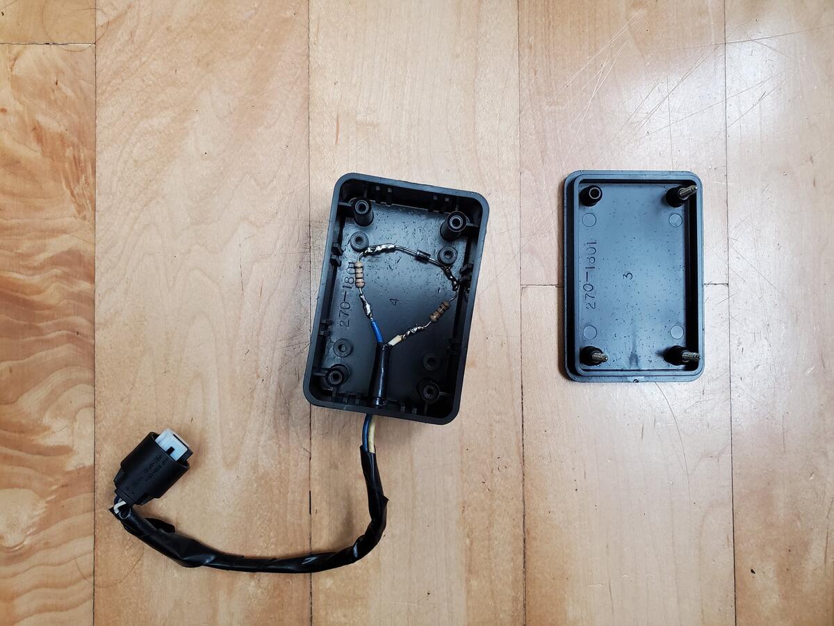

          After coding out the sensor, I got a light on the dash and a code saying something about that sensor. Turns out the airbag module doesn't like it when it's seeing readings from the sensor but is not expecting them. So I went under the seat to unplug it and found this:

          The sensor must have failed in the past and someone installed this to get rid of the light. They must have also messed something up because their sketchy homebrew sensor emulator thing was reporting that the seat was empty. Anyway, removed that thing along with the occupancy sensor module and now my car is happy and won't try to kill my passengers.
