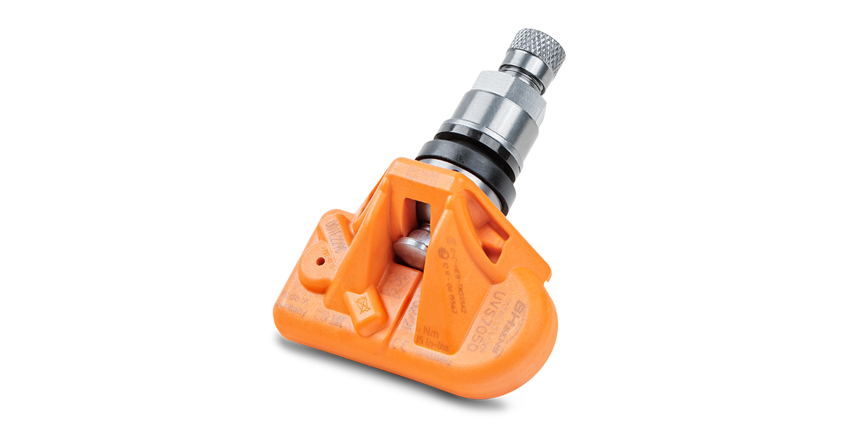

    I am thinking of buying some new 18" ARC8R's to replace my 19" Style 67's and would like to know what I need to do to keep my TPMS functional.
    Apex offers a few different sensors and I don't want to get the wrong style. According to their chart (I have a 6/2004) I need this part no.:
    36-2-36-798-726
    However it also says "non-US models" next to this part number so I am a bit confused on that. They offer free mounting/balancing if I buy wheels/tires from them, so if the price seems reasonable I may just go that direction but I want to retain the TPMS and have it function properly.

    TPMS works via wheel speed sensors on the e46, not via sensors in the tyre.
      Ok, good to know, so its the ABS that's in charge. I wonder why the Apex guy pointed me towards TPMS sensors when the whole conversation was based on the fact the new wheels would be going on an E46 M3. Also their chart in that link shows that part number for an E46 M3 that is the newer direct style TPMS. Oh well, everyone can't know everything all the time.
        That is awfully confusing by APEX. They have quite a comprehensive chart for the E46, too. What the hell are they doing

                    Apex's list for the E46 makes it pretty clear the sensors listed are a non-USDM thing. Plenty of documentation around the FTM system on USDM E46 cars.
