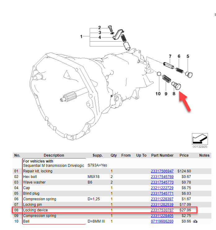

    Having a hard time finding the official torque spec of the Getrag 420g transmission detent spring locking device.. would anyone perhaps have this on-hand?
    Part number should be 23317530787
    Click image for larger version  Name:	lockingdevice.png Views:	0 Size:	102.2 KB ID:	52743
    In fact, if you have both the OE tightening torque specs for both 23317530787 and 23317545769, it would be greatly appreciated for anyone going about replacing the detent springs in these areas. Thank you, much appreciated!
