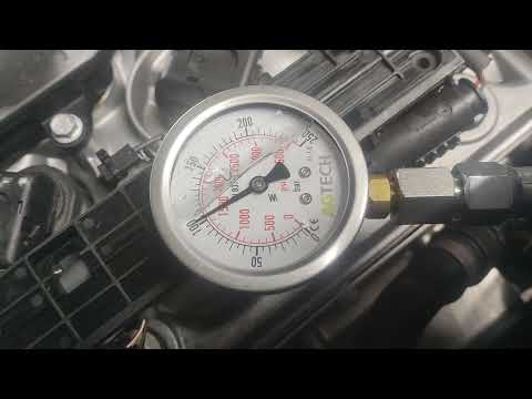

Originally posted by sapote View PostThe video clearly shows the pressure stabilized at about 112, then as engine rev up, it first dipped a bit, not more than 1 bar, then recovered and increased more than initially 112 as rpm increased.
Compared this to the last video which dropped a lot as rpm increased, and this seems like pump had low output rate to supply what used by Vanos.

On cold engine, I have the following video. The car was left a couple of days and then the valve and tester fitted.
revving the engine reduced the pressure as seen in video
It had a nice 115bar pressure and the leak down was not too bad, but not great

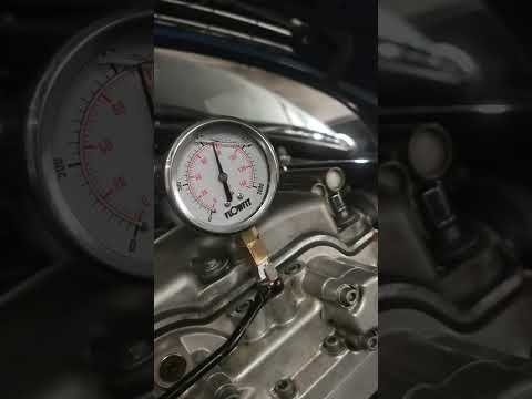

​​​​​​After the above video the car was still cold, I restarted it after leakdown finished and the following video was the next read out. (Assume oil was more viscous after a couple mins of the previous video)
Pressure super low! I tried to adjust the regulator valve and it did nothing, I ran out of adjustments.
I let it warm up and tried to adjust again, only thing I could do was back it out and reduce pressure not increase it to 115 bar; it was the same as the below video for both the cold restart and warm engine (more viscosity to oil)
Revving the engine increased pressure significantly only for the load time
This happened on all subsequent tests too

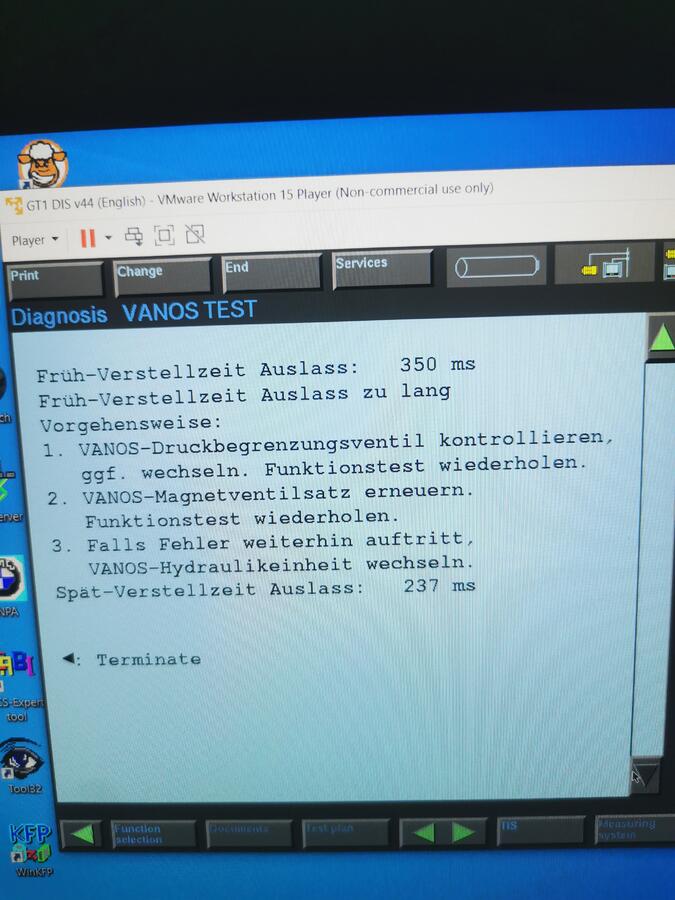

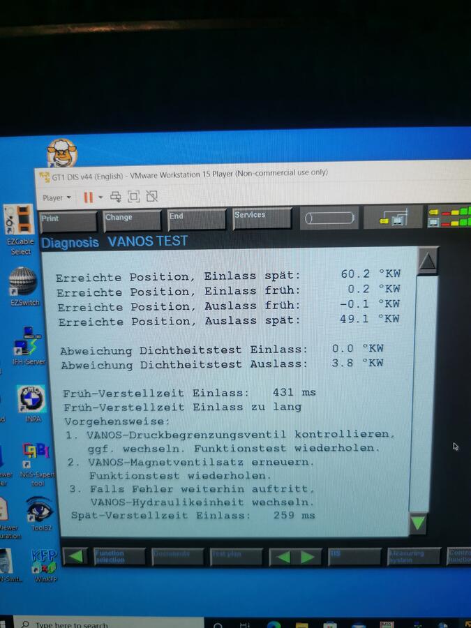

The attached photos is my vanos test results
any advise is appreciated. I have just rebuilt the vanos with new seals. I have new sprocket bolts, new chain guide, solenoid block is clean and free moving, solenoid pack has been continuity tested to confirm no cold solder joints, the disc is the redrilled standard that it came with.
Thanks for the help, I'm assuming ACC or regulator but not sure, also heard about an oil filter between vanos and body that may get blocked?Last edited by Arinb12; 01-13-2022, 12:00 PM.
Your problem is not the accumulator nor the regulating valve, but your VANOS pump, which once the oil is warm, does not generate pressure. this is due to either a worn-out pump shaft, a worn-out disc, or incorrect tolerances of the radial pistons.
I had the same problem, in my case, the issue was the pump disc, I had to source another OE disc, have it redrilled, and the problem was solved.
to anyone doing VANOS work, I now advise to always measure pressure BEFORE as well as run a DIS/ISTA test, and if all is ok, leave it alone. if you feel you need to fix the play with the exhaust tab, then just make sure you redrill the original to your car disc.
I am more than sure this issue with the disc is present in many cars, just people do not test for it, also, low pressure does not necessarily mean the VANOS test will fail as when the rpms rise the pressure rise to a point where there is enough of it to actuate the VANOS splines. however, it is pretty upsetting to know you have a non-confirming system LOL
in your case, your VANOS does fail as the pressure is too low and causes the response times to be too slow.
