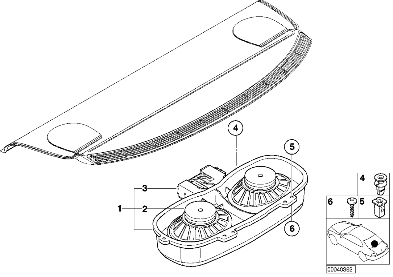

    I read on thr m3f, that they had rear spraker enclosure. Maybe jbl, its hold a 8 inch sub. It mounts to the rear deck, for each speaker. Do anyone have these installed or know a speaker upgrade for them, and a DIY on the install.
    Maybe referring to the Harman Kardon subwoofer mounted under the rear deck? Might be some after market solutions that use the mountings.

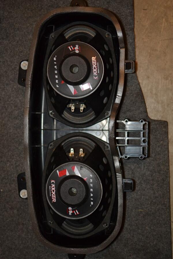

          I heard good things about the CDT option but I went the kicker freeair route. Tough to find but I couldn't be happier with the quality.

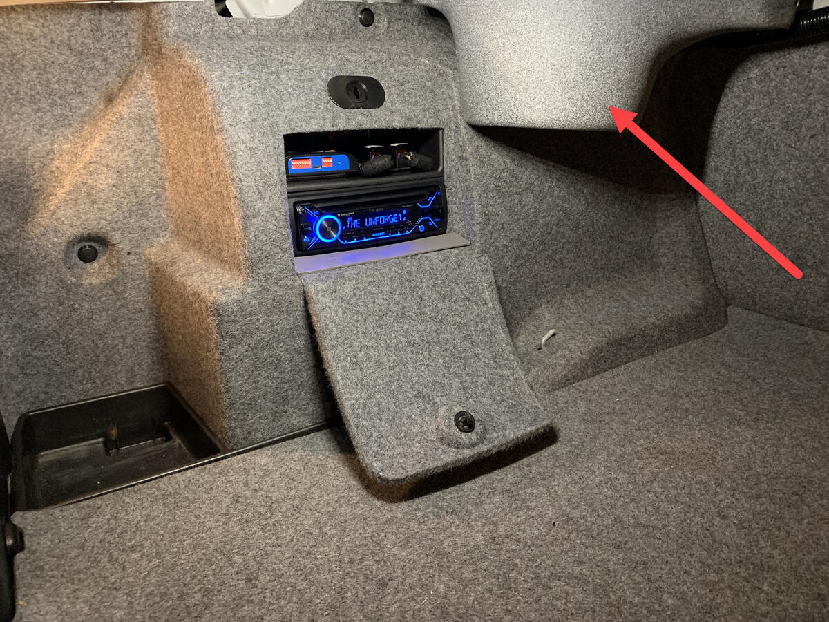

                  You have the speakers powered off of another amp?
                      Yes I have removed all stock audio parts (Besides front speakers, deleted Nav, BM53, HK amp, HK Sub, Bluetooth module, and rear fill speakers). Front HK components and JL sub powered off JL amp and Avin 4 headunit.

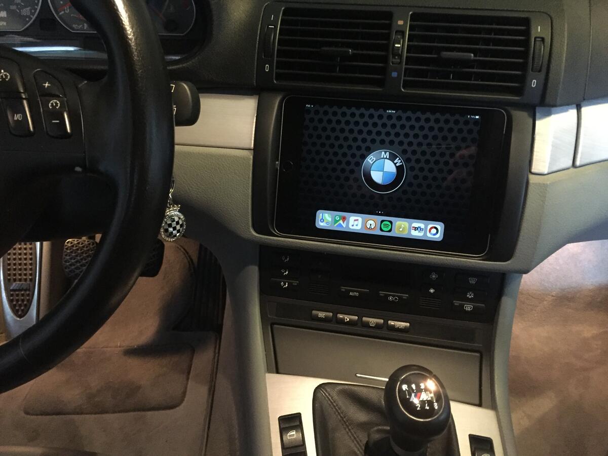

                        So I see the stealth box. But please elaborate on the head unit setup. What’s In the dash? Pics? How’s it controlled?

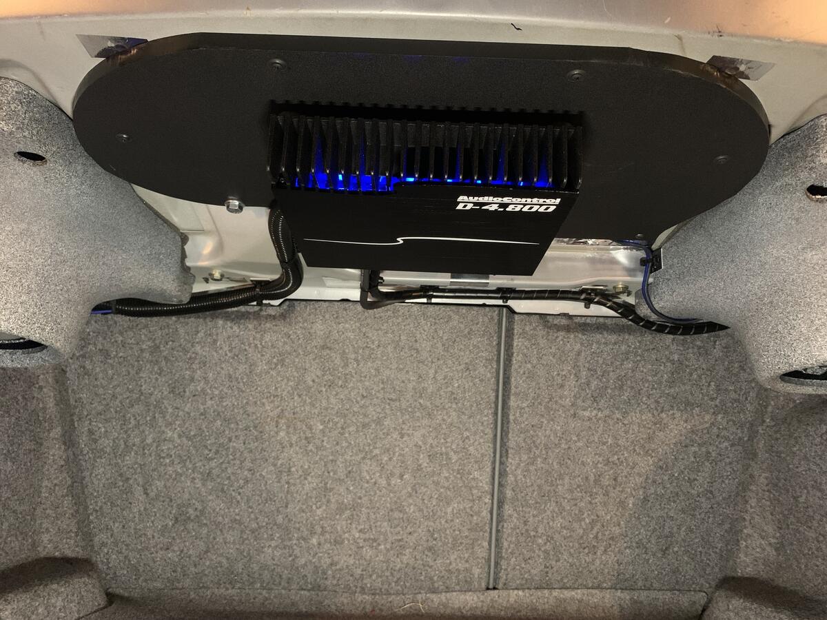

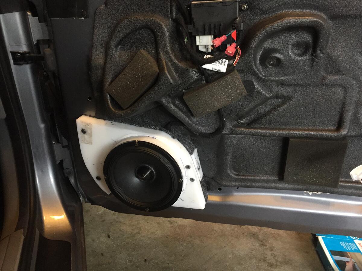

                          iPad mini in the dash connected to "head unit" in the trunk with a USB cable. A PAC ControlPro 5 programmable SWC interface mounted just above the head unit allows control via steering wheel audio controls. For calls my cell phone connects to the head unit via blue tooth and I mounted a hands free mic with a long cable up in the stock location.
                          The rear tray speakers were replaced by the stealth boxes. I pulled the HK subs and mounted an AudioControl D-4.800 amplifier to the bottom of the rear tray. I pulled all six front door speakers and replaced them with 6.5" Alpine Type R separates. The tweeters went right into the stock location, but the woofers required surgery to the doors and the door panels. It all looks stock with the door panels installed.
