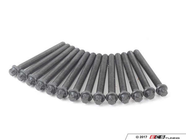

                      As far as head bolts go, I was planning on the OE for them iirc are priced around 40-60 bucks. Although ECS lists a brand that is a fraction of that at like $20 or so. I don't think I will want to risk having to do the job again to save $40 but I am curious to see if anyone has chosen to use those head bolts.

                        I’d go with bmw head bolts. This isn’t a spot where you want to come back to because of $100 (valve seals + head bolts)
