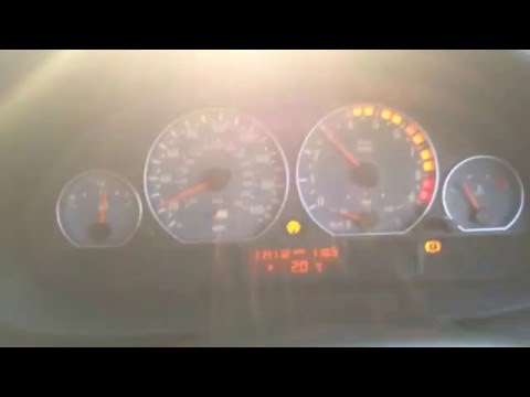

                Keep in mind this is an extreme example, but does the rattling sound like this? LOTS of documented info on m3cutters. And what was the actual code that your car threw regarding coolant temp? I have the same symptoms as you, just got the coolant temp (P0128) code last week on startup. Compression test done 5+ years ago on startup, all cylinders were low around 140.

                  Mine didn’t sound like this. This sounds raspy. OP provided a great example of the noise. It sounds like a clean ICV when on the throttle.
                    Was the sound closer to this?
                      Here are the compression test results, my understanding from this is that my issues are running deeper than just the head gasket.
                        https://www.youtube.com/watch?v=U0xWd72f4g8
                        That was a lot more like the sound mine is having. Definitely not as pronounced and as raspy as the other one.
