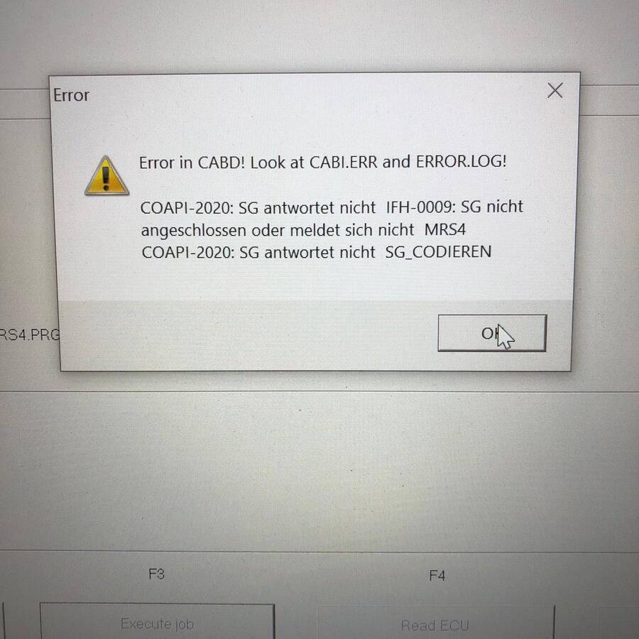

                        Ok I went back and set both ABG module Seat Occupancy lines to not_active (ERKENNUNG_SITZBELEGUNG_1, ERKENNUNG_SITZBELEGUNG_2), but still got the same error prompt message when I tried to write back the .man file to the module in NCS Expert.
                        Not sure whats going on, I've coded a bunch of other modules recently with no issues, and have only gotten an error when trying to get rid of my airbag light now..

                          #57
                          Click image for larger version Name:	IMG_7277.jpg Views:	0 Size:	80.0 KB ID:	67774
                          Try a different profile. Also, just try repeatedly.
                          For reasons unknown, airbag modules sometimes can be a PITA to code.
                            #58
                            Haha yeah I read the ABG module can be finicky and sensitive, and doesn't really like being messed with.
                            I've been using 'Revtor's NCS Expert Profile'. Is there another profile with manipulation enabled you could recommend?

                                #60
                                Following up about the airbag light, I was able to finally resolved it.
                                First, I cleared two stored fault codes with Martyn's excellent DME Utility tool (strangely neither seemed airbag related), then reattempted the ABG .man trace file write with all the occupancy related lines set to not_active (surprisingly there were actually 6 relating to 'occupancy', but strangely all were already set to not active, including the two I had attempted to disable but got write errors on my last write attempts).
                                The coding write back to the ABG module went successfully with no errors and the airbag light went away! Whooo!
