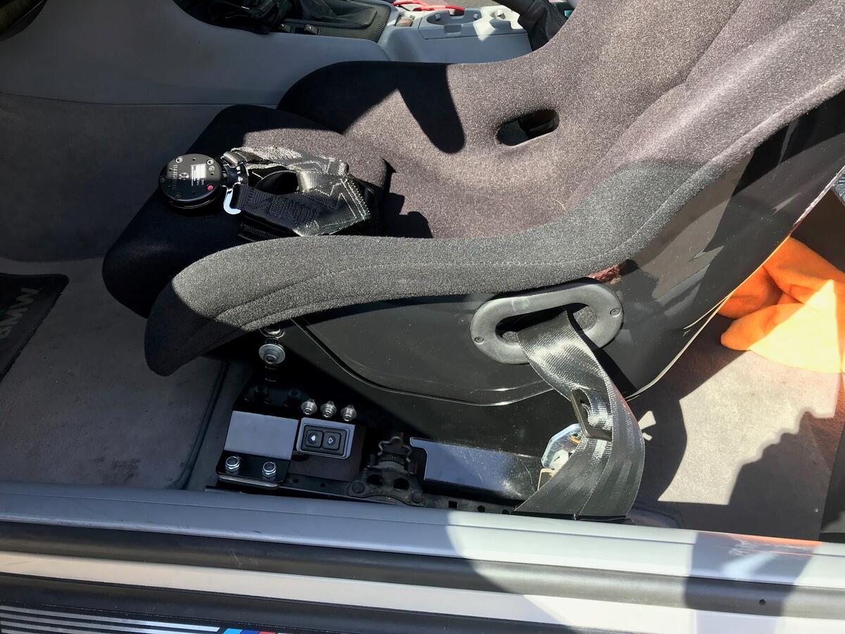

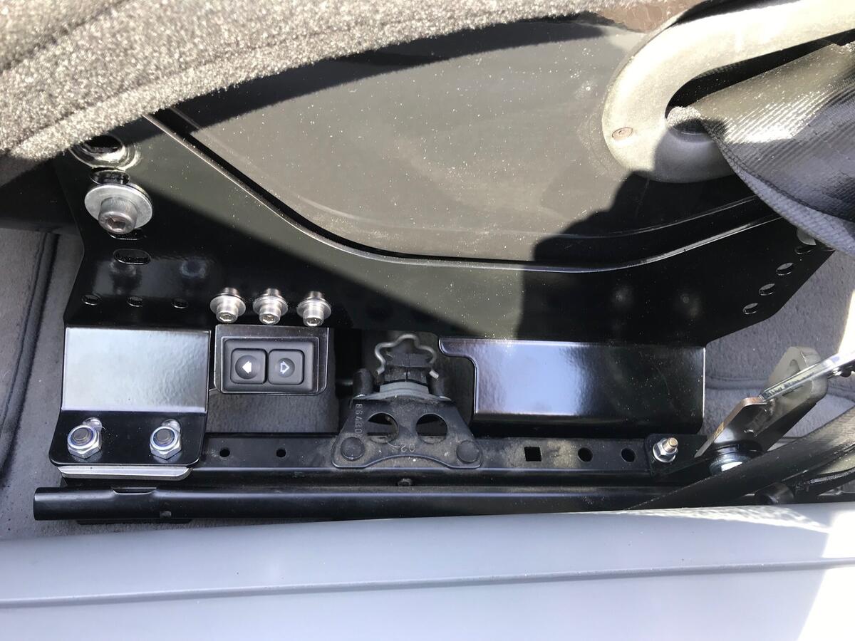

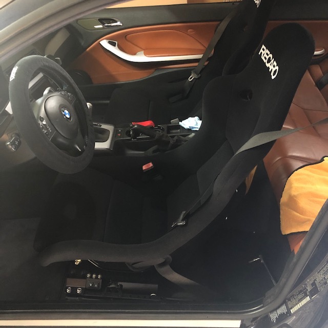

    Finally got some photos for you - ignore the mess in the back seat.
ID:	55334 Click image for larger version
ID:	55336 Click image for larger version

      That looks really good, thanks for that! I was having a hard time finding manual E46 oem sliders and was considering keeping my powered sliders and going this route, rather than the direct-to-floor fix mounts.

        The sedan sliders are actually better for this purpose— they have lap belt mounts on both sides, whereas the coupe have them on the inside only.

            The factory receiver actually bolts to the slider, not the seat— so you’ll still use the stock mounting location for it If you use the Bk slider mounts.

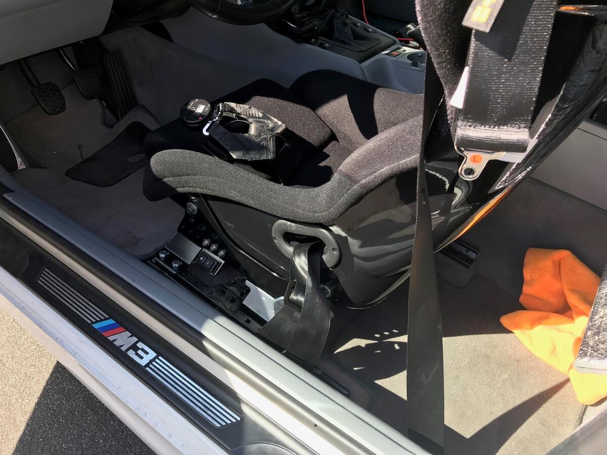

                      Damn,
                      I wish I got the ABE seats as well. I got the regular PPs here in the states. I ended up running the center rear seat belt buckle as a solution for now. Running the Recaro sliders and Macht Schnell floor mounts.
                      Edit: Even with sliders, it will be a pain to get something in the rear seat. I put my sons car seat through the trunk. LOL!

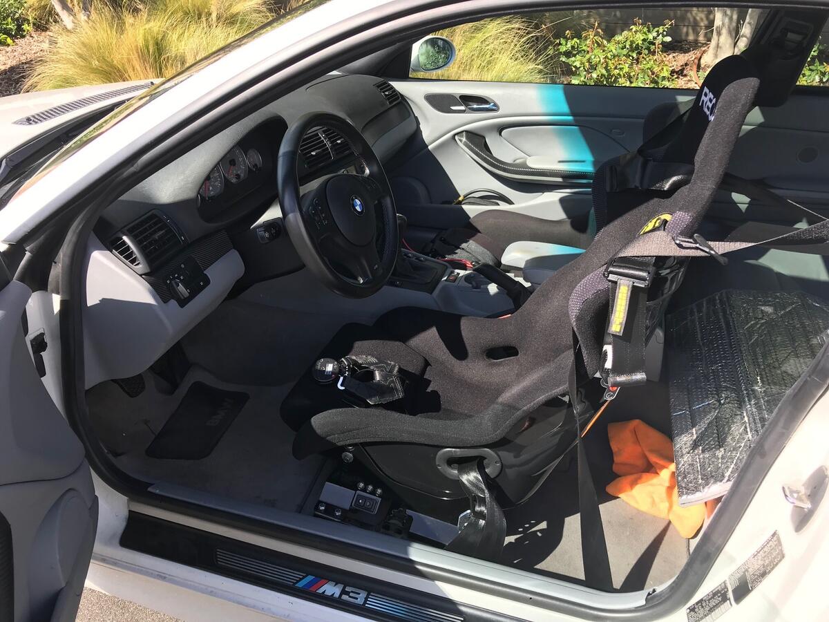

                            Damn,
                            it looks like you're overly reclined. The headrests should be ~vertical for a proper seating position. Make that change and you'll gain better back seat access as a perk.

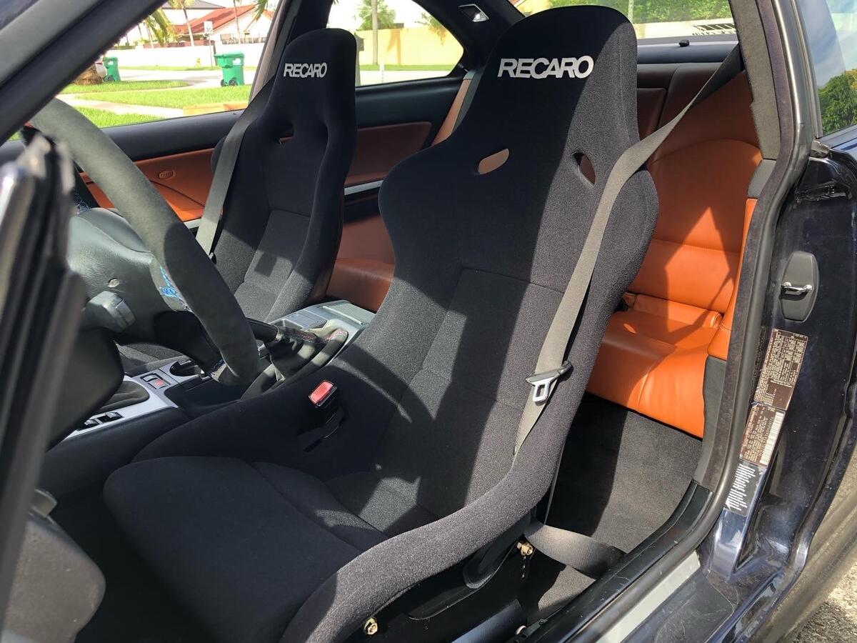

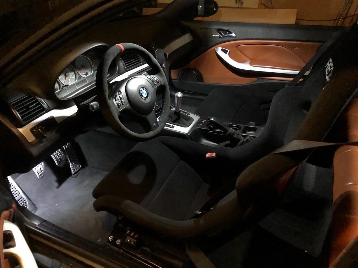

                                Following up with my results to help out anyone who might be doing this same install in the future, can use this thread as reference. Ill put pics, links, and wiring info in this post.
                                I was able to finish up the install of the PP ABEs w/ BK mounts and OEM power sliders. I am extremely pleased with everything! The seats feel fantastic and are actually quite comfortable, I no longer fall out of my seat during spirited driving and can actually feel what the car is doing during hard cornering. The ABE versions are definitely the move for a street car retaining the functionality and convenience of the factory 3 point belt; the receiver fits through the inboard hole perfectly and they even have elastic straps to hold it up, so it doesn't jam into your hips when getting in. And the BK mounts with the power sliders is icing on the cake, and perfect for a street car. I wish I had bought this setup earlier! I'm also going to be hitting a HPDE at the end of the month to truly test out the seats.
                                First, pics of the completed install:
                                Click image for larger version  Name:	IMG_7110.jpg Views:	0 Size:	76.5 KB ID:	67628 Click image for larger version  Name:	6EC5B71E-5E65-4B0E-8570-85CE7BDAEB56.JPG Views:	0 Size:	147.6 KB ID:	67630 Click image for larger version  Name:	5D322212-2D0D-4B0A-B967-92A1EB882B65.JPG Views:	0 Size:	106.2 KB ID:	67629

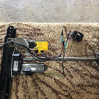

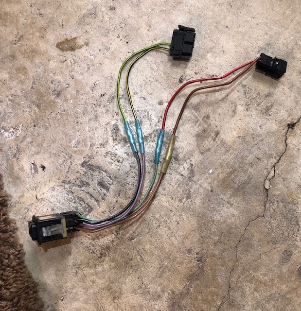

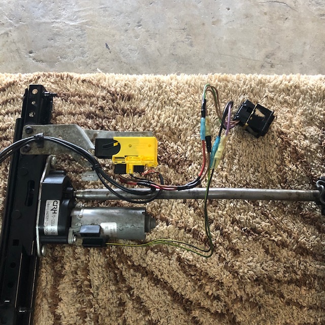

                                Some info on the install:
                                For the wiring I ended up cutting the power and lower rail motor connectors off the seat harnesses to use for wiring up the E30 switch. Luckily, I was able to find two used E30 window switch wiring harnesses on eBay, so I was able to use the E30 window connector for the switch rather than having to directly wire to the switches pins. Also bought 2 new aftermarket non illuminated switches from pelicanparts.com. ($15 each, they actually ended up sending me 4 so have 2 extras, if anyone needs let me know)
                                https://www.pelicanparts.com/More_In...-367-373-A-INT
                                I then crimped the E30 wiring harness with the power and rail motor connectors and wrapped it up with OEM style Tesa fabric tape (amazon link for fabric tape below)
                                https://www.amazon.com/gp/product/B0...?ie=UTF8&psc=1
                                (passenger side pictured, the drivers side had a couple extra wires and different harnesses. Same concept, the extra wires I believe are for seat memory which you wont need anymore so can ignore or snip off like I did)
                                Click image for larger version  Name:	IMG_7048.jpg Views:	0 Size:	195.2 KB ID:	67631 Click image for larger version  Name:	IMG_7105.jpg Views:	0 Size:	190.1 KB ID:	67632
                                For the Recaro seat bolts I went with 20mm length Zinc Yellow-Chromate Plated Class 10.9 Steel M8 × 1.25 mm bolts from McMaster-Carr from bigjae46 recommendation. 20mm was the perfect length for my application and I used the included 2mm BK spacers between the mounts and seat.
                                https://www.mcmaster.com/metric-clas.../length~20-mm/
                                I forgot the washers so just got some zinc yellow chromate grade 8 ones on Amazon. Both the bolts and washers came next day surprisingly quick.
