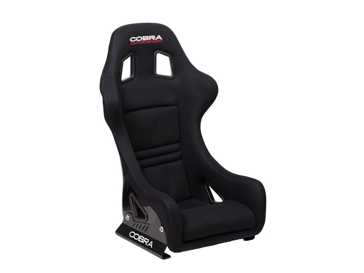

            So another seat Im eyeing for this reason is the Cobra Suzaka Pro-Fit, looks similar to the other seats I listed but the side holes seem not only much bigger (that a 3 point buckle could fit through), but also seem very low to the bottom cushion, so hoping the lap belt can sit snug, compared to the Recaor PP/SPG or Sparco EVO QRT. Unfortunately I dont have access to any of these seats to test out in person, Im just going off pics on the respective sites, and there's not even many or hi-res

              I run the Cobra Nogaro Circuit and really like it for a weekend car. Definitely not if I was daily driving. It's not the cheapest, but it looks great, can use BMW rails, even powered, and the factory lap belt isn't super sketchy.

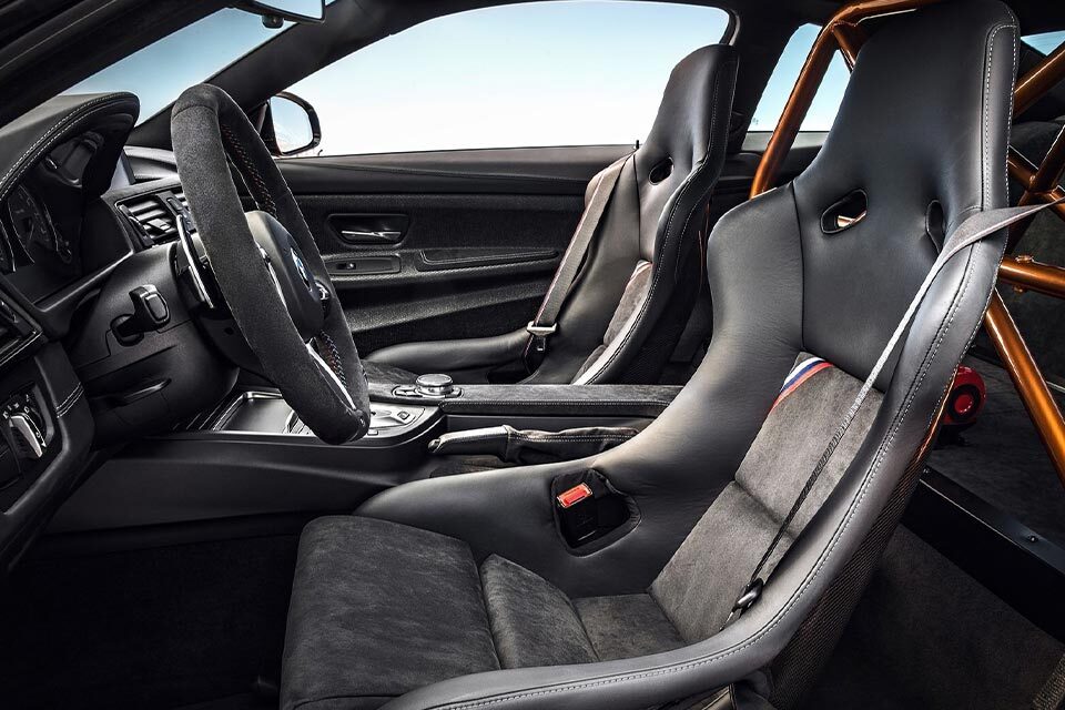

                A good fixed back seat to run the stock 3pt seatbelt is the Recaro Pole Position ABE/TUV version (Europe only). The hip area is a little wider and indented to accommodate the OEM seatbelt receptacle. If you looped the seatbelt on one side through the belt hole, you would have a much better waist restraint. The lap belt would no longer be resting on the side bolsters but rather directly on the occupant's body. This seat is similar to the version found in the M4 GTS which is OEM in Europe.
                  This ebay seller has them available: https://www.ebay.com/itm/RECARO-POLE...ff08%7Ciid%3A1
                  Click image for larger version  Name:	bmw-m4-gts-05-960x640.jpg Views:	26 Size:	114.0 KB ID:	54993
                  You are the MAN! Thank you, this is just what I was looking for my situation! I wasnt even aware of the ABE/TUV versions were for road car and 3 point use, they seem to be perfect for my application! And extra thanks for the ebay vendor link since they're not available in the US (surprising considering we're usually wider lol). I'm eyeing the black velour pair he has, price is very reasonable too even with shipping from Germany!
