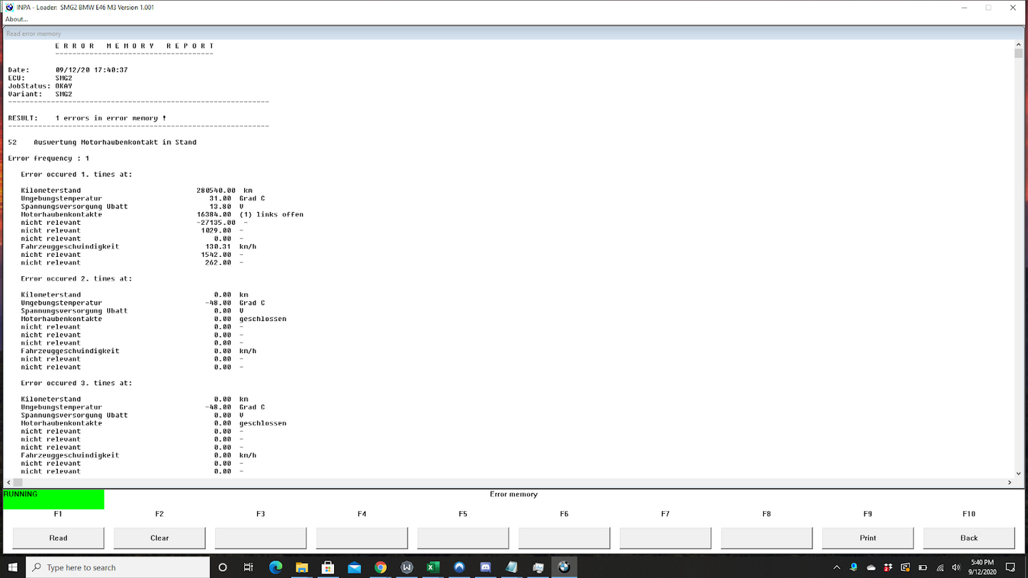

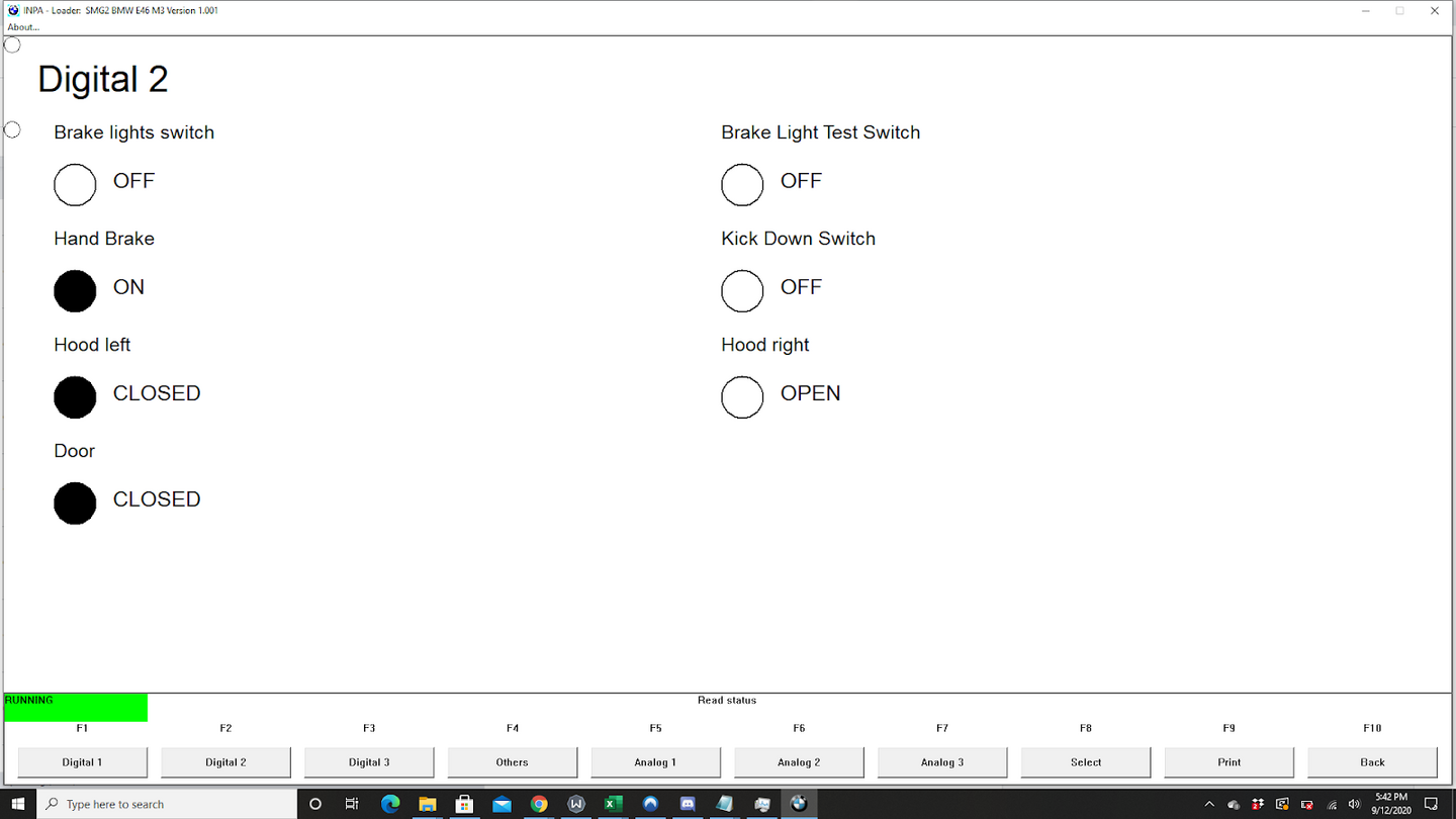

          Here are some screenshots. Hopefully this helps.
          My research tells me that code 52 has something to do with the bonnet contacts.And just to confirm, that's the spring that goes into the hole near the front of the car. I've cleaned it and everything...

            There are two of them. Make sure they're both operational (also give the hood a little more slam to shut it good and actuate the hood switches).

                    INPA indicated hood switch right is OPEN hence code 52.
