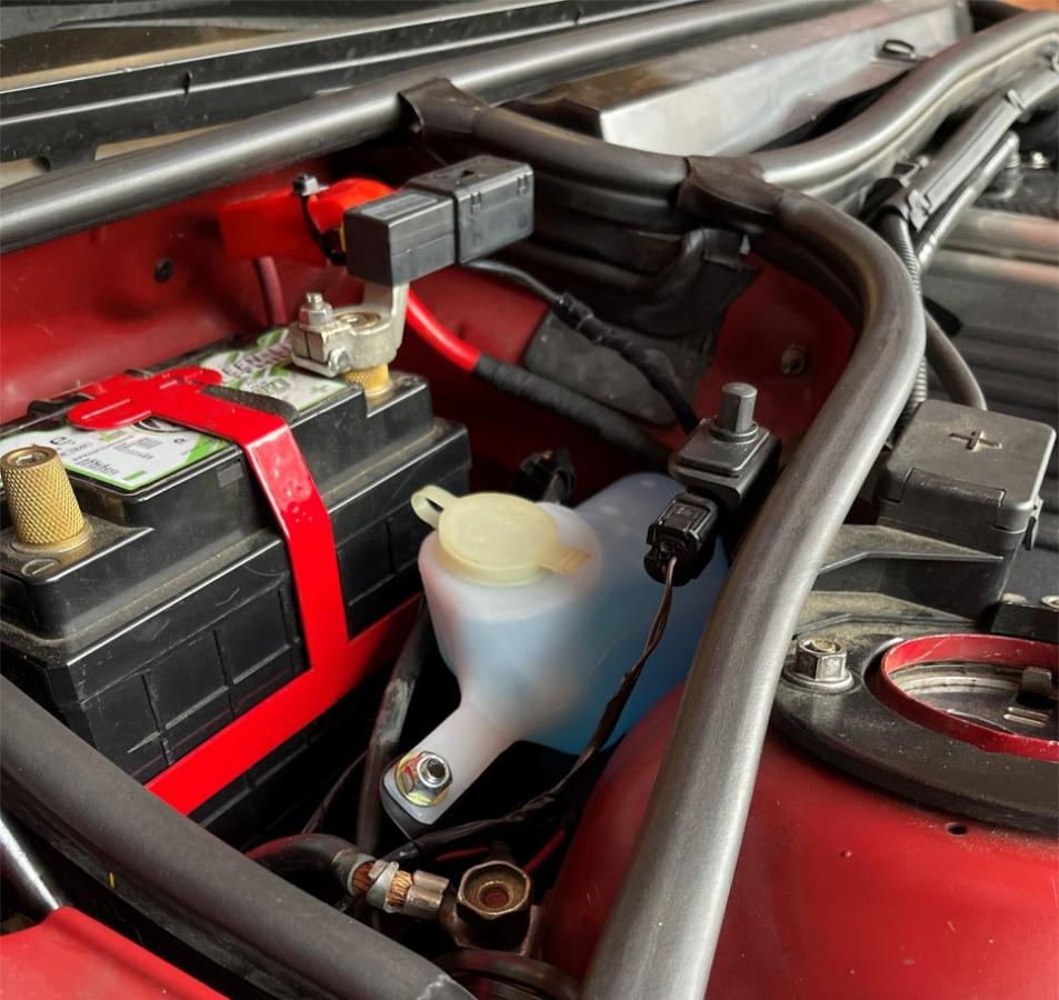

                      For others reading:
                      3) lithium ion battery/battery cable delete
                      4 cylinder e46 coupes (not sold in the USA) had the battery installed in the drug bin. My lithium battery is 5.6 lbs, so it wasn't doing anything meaningful for weight distribution in the trunk. I bought the factory under hood wiring parts for a 4 cylinder car and made a bracket to mount it in the drug bin. I pulled all the factory battery mounting hardware out of the trunk and, since my interior was already gutted at the time, pulled the positive battery cable that runs to the trunk (which was surprisingly heavy-- 8 lbs per real OEM IIRC).
                      I even happen to have an up to date picture on hand, as I took a picture of the washer fluid level a month ago to see if I'm losing fluid (just replaced the pump gasket because I was).

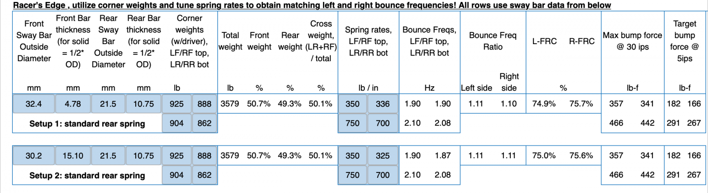

                          I recently had my corner weights taken and started messing with the spreadsheet. What section of the spreadsheet should I start with?
                          Regarding the spring rates, aren't we limited to what is actually available for sale? Like 700# 750# etc.
                          I am trying to get 1.9 hz front, 2.1hz rear like Obioban mentioned.
                          attached is my corner weights and what I have input at the moment.

                              Just get close with the rate, I highly doubt anyone can tell the difference between a few % difference or imbalance. Besides - springs don't always measure what they're labeled at. I bought an Eibach 600lb spring that measured 580 on a calibrated tester.
                                #90
                                Yeah, you're limited to what exists. You can game it by using metric spring rates, and springs are cheap enough that you can buy a couple and measure them to get one close to what you're looking for. E.g. but a couple 700s and use the one that measures high.
