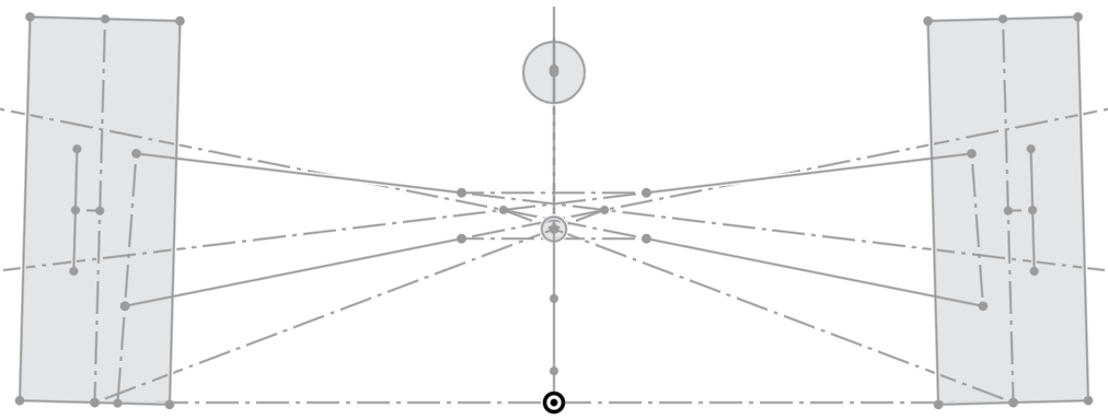

      I know the e36 is substantially similar but I’ve not measured one myself, so I can’t say for certain. The dead giveaway is how close the inner bushings are between the upper and lower control arms.
      Effectively this means you have a very stable IC and RC which actually serves to hurt more than it helps because there is a substantial jacking force pushing the rear of the car up. A properly setup e46 front suspension should have very nearly zero jacking force, so this gives the feeling of the rear end ‘lifting’ on steering inputs, as well as providing some inherent front end grip or rear end looseness on turn in or suspension load-up before achieving steady state. It’s even worse if you’re lowered more than an inch or so as your front will actually jack DOWN and pull you into the bump stops/require more sway bar.
      Personally I think this is the biggest downside of the e46 suspension and is the primary reason that folks can find grip with stiffer than otherwise optimal ride frequencies, as stiff springs will serve to mitigate the displacement of the chassis upward from the jacking force. A lower rear roll center would get you much closer to the static suspension behavior during dynamic events. Effectively your front/rear roll stiffness is always changing rather largely, and not due to your springs or dampers.
      Originally posted by ethan View Post
      Would you guys comment on the impact of that rear roll center and motion ratio for divorced spring vs rear coilover setups?
      Does applying the motion ratio to your spring calculation really account for all of the differences in suspension performance between these two rear setups?
      I believe that the e46 rear spring motion ratio is designed purely to mitigate jacking of the rear suspension. With a stiffer inboard vs softer coilover spring, the car will actually lift/jack less and keep more stable rear suspension geometry. I would never recommend anyone to run a true rear coil over for this reason, your car will literally lift up more in the rear and cause additional unwanted geometry changes.
      I honestly don’t know why they chose such a high rear roll center and such an inboard instant center. The only two things I can think of are 1) that it makes the car have a tendency to break rear traction on quick steering/throttle inputs (think Scandinavian flick), 2) that it will make the front end really bite hard when you wrench the wheel (versus say a 911 which is setup opposite), or 3) that the car is designed to be really weighted down in the rear with passengers and gear and they did this to mitigate smashing the bump stops and upsetting the car. Some day I’d like to make a rear subframe that corrects this geometric ‘flaw’ … okay off the soap box.
      edit: here’s a photo of my model
      Click image for larger version  Name:	Stock rear roll center.png Views:	0 Size:	62.9 KB ID:	270532

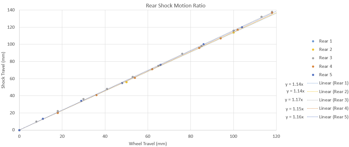

        I did each one multiple times to get an average. The front is easy, but the rear can be tricky to measure spring displacement just due to the tight packaging of it.
          I did not do a bounce test, but that's a great way to measure it directly and also extracting the non-shock damping/friction.
          Keep in mind that the rod force / damper gas force (especially on a higher-pressurized monotube) WILL contribute to the suspension's friction as it behaves like a capacitance / damper 'preload' that must be overcome before the suspension moves into compression. The rod force + very low speed compression can combine to create some nasty jerk... This rod force CANNOT be ignored except at the cost of grip and ride quality.
          What setup are you using, btw? damper rod diameters front and rear? Do you have know the rod force on your dampers, and seal drag? I just started measuring the latter a few years ago - very revealing. And have you done any frequency-based damper force analysis?

            cobra Some good science right there! Thanks for sharing your data. I'll update the E46 M3 spreadsheet rear damper and spring MR with the values you obtained.
            EDIT2: I tried to do a quick and dirty HTML edit on the MRs but looks like I need to regenerate the JS function calls via Spreadsheet Converter, which I don't have on this new computer. I'll get that taken care of soon as possible. The original version is what's in place and I'll advise when v2.0 is available.

                My car is stock other than the shocks/springs. I removed the spring and disconnected swaybar for these measurements.
                Towards full droop, the lower control arm touches the spring at quite an angle. I was measuring at the center of the spring mount
                  Over what range did you measure the motion ratios? I generally exclude wheel vs. damper travel data below static height and focus on static height to full bump. Any non-linearity going into droop would skew the calculated MR.
                    This was pretty much the full range of shock travel. My shocks are a little shorter than stock hence only 120mm and not 140-150. Either way, it looks pretty linear so I didn't bother clipping the ends.
                    You asked earlier what shocks - I am running a custom monotube setup with piggyback reservoirs and base valves, 22mm front and 16mm rear shaft diameters, at about 75psi.
