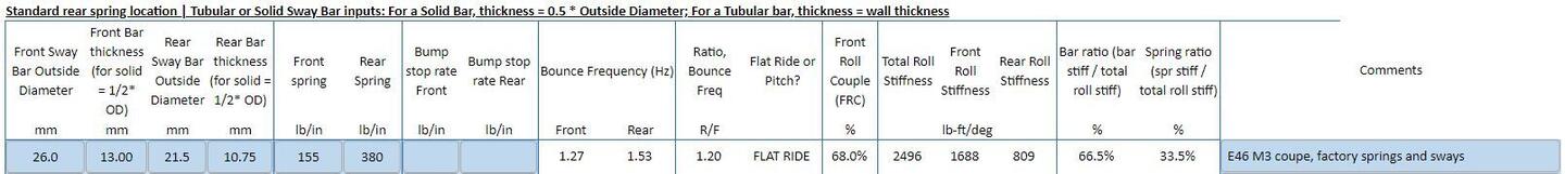

    As a reference, here are the suspension calculations on a stock e46 M3. These details are listed in the spreadsheet calculator by default.
    Click image for larger version  Name:	e46 M3 stock flat ride.JPG Views:	0 Size:	41.0 KB ID:	58366​

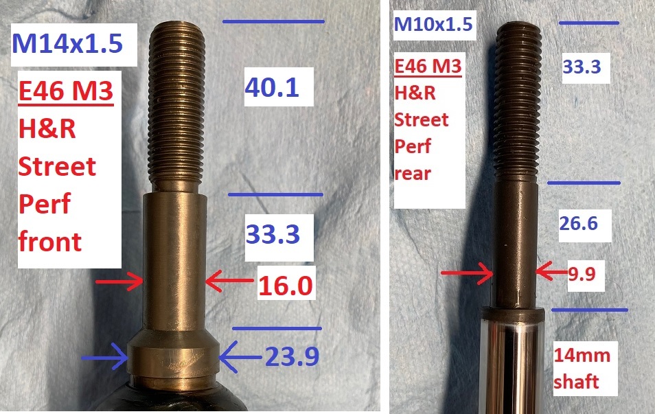

    Here are some additional details for the H&R front and rear damper damper shafts. You will need to know this info for making sure your camber plates and rear shock mounts fit correctly. I am using Vorshlag camber plates and rear shock mounts. They have all the dimension info already, just let them know you are using the H&R dampers.
    Click image for larger version  Name:	BMW_E46_M3_H&R_Street_Performance_front_strut_rear_shock_top_mount_dims (1).jpg Views:	18 Size:	224.3 KB ID:	58230

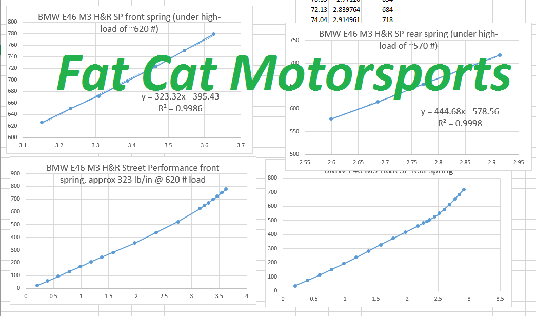

    I wont go into a lot of details here, but lets first talk about the springs that come with the H&R Street performance kit. FCM has measured the springs in the H&R Street Performance kit (see the data below). They are 323 lbs/in (front) and 445 lbs/in (rear) linear springs. Be aware that the spring rates that come with this kit do no give you Flat Ride. These spring rates result in 1.8 Hz front and 1.6 Hz rear bounce frequencies. Consider getting new springs.

            I have Z4M H&R Coils, and the rear perch is the same as the E46 M3 kit, it is 60mm. I also compared the springs from the Z4M kit to the M3 hoping they were the same and no, wire diameter is different.
