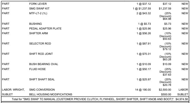

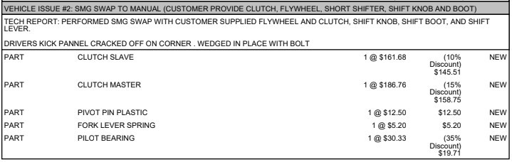

Name:	smg swap 1.jpg
Name:	smg swap 2.jpg
                            This is in the Bay Area, CA, so I'd imagine this is on the high end for pricing. However I also supplied some parts.
                            2004 Dinan S3-R M3
                            2023 X3M Competition
                              #44
                              What is "SMG swap kit"? They charged $500 for bellhousing mod, so what is the said kit?
                                #45
                                I'm not sure TBH. I assumed it was all the ancillary parts needed for the swap, ie bolts, gaskets, pedals, etc
                                2004 Dinan S3-R M3
