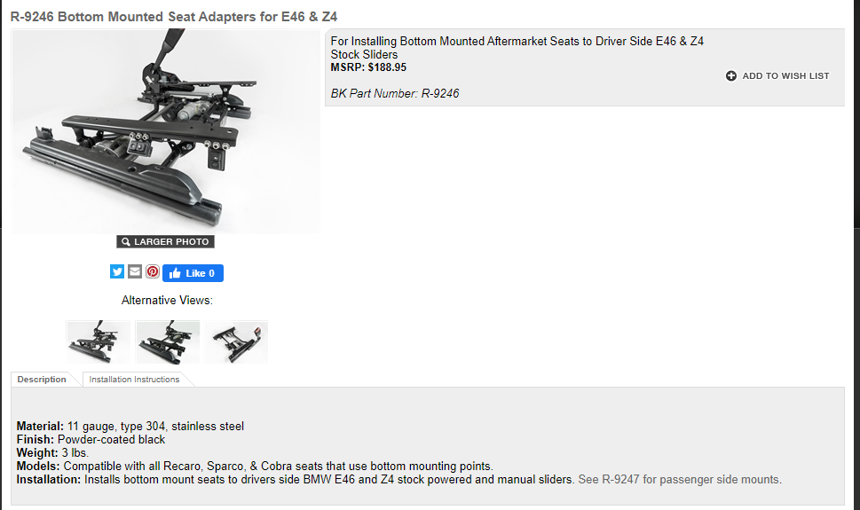

    Now, i see the R-9246 and R-9247 which if i'm understanding correctly, should allow me to use the PP seats with OEM sliders, retaining the power controls.
    Are these power controls to slide front-and-back, as well as up/down? Seeing two switches.
    And put the PP seats on the Recaro's side mounts, and the side mounts i'm guessing are what gets mounted to the BK sliders. At least that's what the installation PDF seem to suggest.
    If not using the OEM power controls then looks like i need to also get R-9226 and R-9227.
    What do you guys think about this route of mounting Recaro PP seats?
    Seems like descent way to retain OEM controls and look.

        The 9246/7 are for bottom mount seats, like the Sporsters.
        For Pole Positions, you want R-9222 and R-9223

          I don't know what a bottom mount seat is, until now. So, Pole Positions would be side mount seats then.
          I guess what drew me to R-9246/9247 is the pictures showing "two" slider switches.
          I'll check but can the 9222/3 used the same way with OEM sliders as 9246/7 to put "two" switches?
          I see folks have at least one power switch for sliding front and back.
          Wondering if folks see less value adding second switch to the OEM slider with BK mounts.

              Yes, the PPs are side mounted seats.
              The 9246/7 actually only have one switch each. The picture on the listing there is a 9239 (e39 bottom mount seat mount).
              There is no e46 setup with on the fly tilt adjustment (what the second switch does). The 9222/3 have multiple front holes, to allow you to set the seat angle, but not on the fly.
              On the e39, the tilt motor is built into the slider. On the e46, it's built into the seat. So, no way to use it with aftermarket seat mounts.

                Thanks for that clarifications.
                I was able to find the BK page on 9239 buried from the home page, which didn't list e39.
