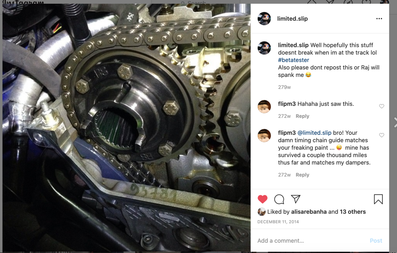

                  Plenty of things to like about Raj/Beisan. One of them is extended testing prior to releasing a product.
                  Here's a prototype Beisan hub in my car circa 2014
                  12 likes, 3 comments - limited.slip on September 2, 2015: "Well hopefully this stuff doesnt break when im at the track lol #betatester Also please dont repo..."
                    Wow! How many miles does that unit have in your car now?
                      #40
                      So much has happened since, I couldn't say, sorry! I sold that car quite a while back to. I do remember pulling the hub after some miles and sending it back to Raj for inspection/tweaks.
