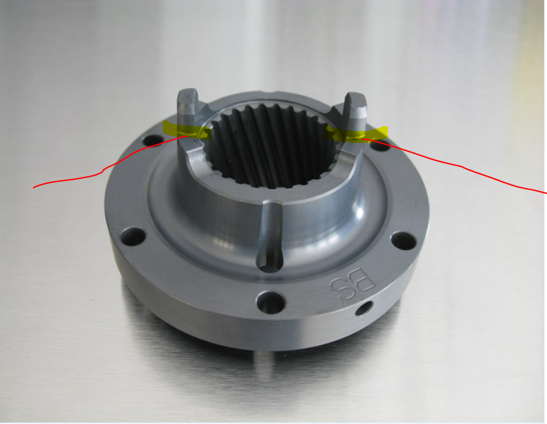

      I look at Beisan and OE hub design and they all have the sharp 90* corners at the base of the driving tabs. This causes stress raiser and crack. The tab corner should have radius which is common practice in metal making.
      with radius base, to fully mate with the disk which should have chamfer holes. Even without chamfered holes the radius tabs still can insert but there is a gap in between hub and disk. The chamfered holes will have zero gap and less cantilever on the tabs.
      Don't know if VAC hub has radius tabs or not.
      Click image for larger version  Name:	image.png Views:	0 Size:	388.0 KB ID:	274117​

        OK, so Beisan new hubs don't have larger tabs to reduce clearance on the stock disk holes. It is very much the same result - tab to hole clearance - as stock hub on stock disk.
        IOW, don't use Beisan hub on stock disk to reduce the holes clearance. Use VAC hub in this case.
        But why wouldn't you just have Beisan drill your stock disk at the same time you purchase their hub? I can't imagine willingly giving VAC money at this stage in the game. The Beisan combination is even $50 cheaper.
