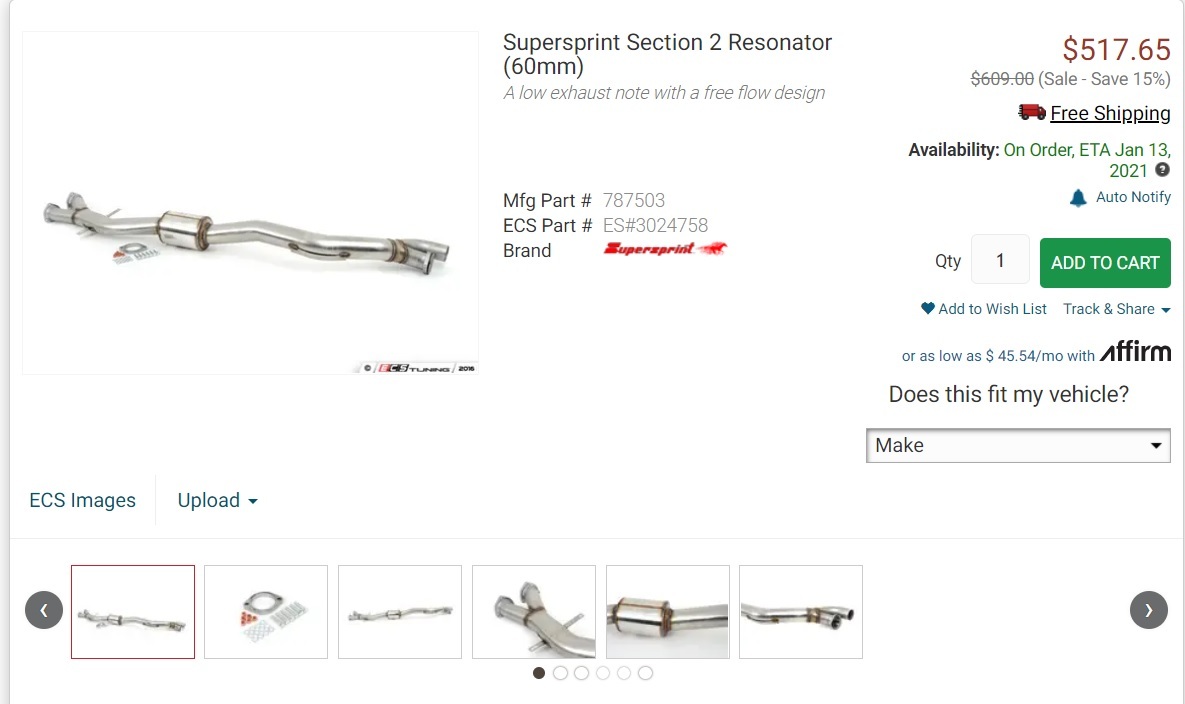

      This one - Supersprint Section 2 Resonator (60mm)

        Ya, called the x pipe usually. Either way, I would always get a resonator. Resonators don't impede flow like cats do, in fact, they speed flow up a hair. And cancelling unwanted frequencies isn't a bad thing anyway, esp given that the x pipe gives a nice sound.
