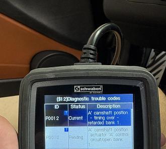

    SES engine light popped up the other day while daily driving, and when I ran the codes P0012 was a "confirmed" code, and P0010 was a "pending" code. Not sure what the difference is between confirmed and pending.
    P0012: "A" Camshaft Position - Timing Over-Retarded
    P0010: "A" Camshaft Position Actuator Circuit
    Forum advice told me this was the Beisan Solenoid so I replaced that this afternoon along with the orings, and my P0010 code cleared, but P0012 remains. It seems unlikely that swapping the solenoid only cleared one code. Since both the codes appeared at the same time, I would expect one underlying issue to be the culprit, and as a result would've expected the new solenoid to either clear both codes, or neither of them. Do I need a new intake camshaft position sensor? Is there a test I can run in INPA to see if the sensor really is bad before I buy one?

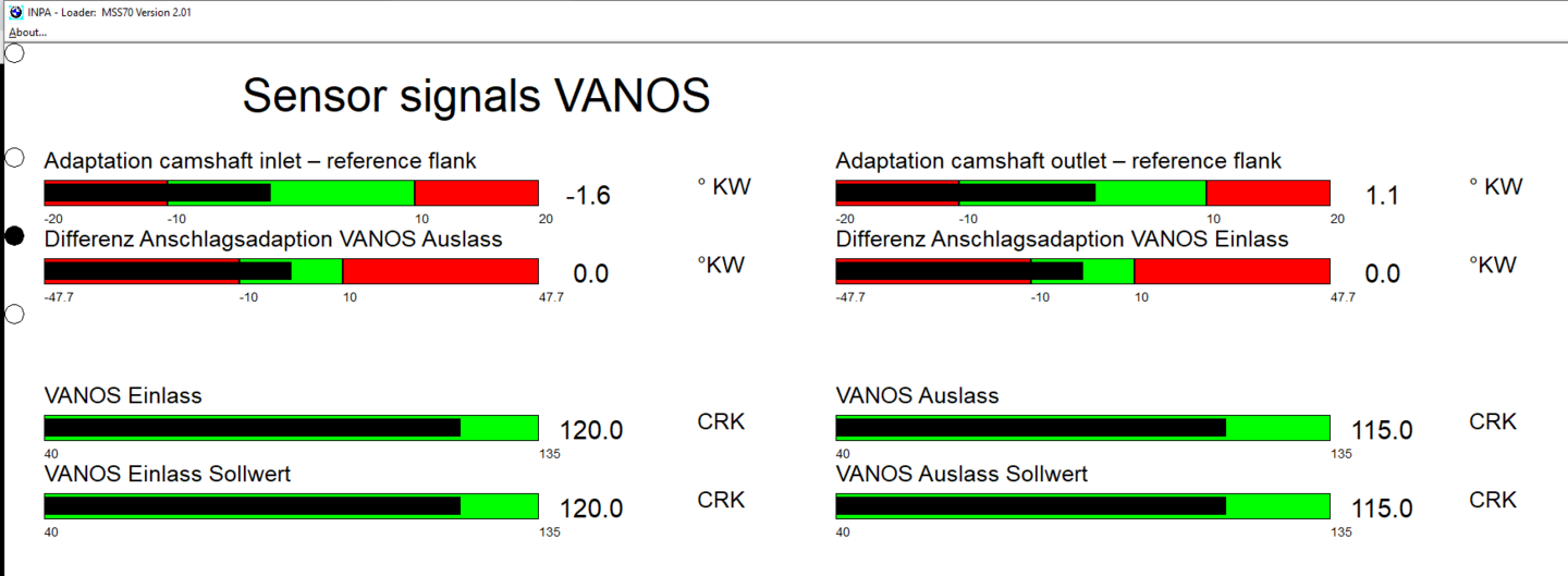

    This is what I am talking about in INPA
    Click image for larger version  Name:	Pre-Rebuilt-VanosAdaptation.PNG Views:	0 Size:	144.5 KB ID:	61019
    In the image above the engine was not running, so the request and actual values are the same, but when the engine is running you will be able to tell how far apart they are, the adaptation values will tell you how much the DME needs to compensate to achieve the requested value, as long as you are in the green zone you are good, ideal would be zero.

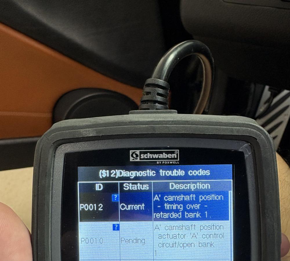

                    Thread revival: Just got the same codes as OP. Can someone verify if the issue was the Beisan solenoid? If so what’s the best option for replacement? I got the full preventative beisan vanos overhaul about 15k miles ago (pretty sure beisan solenoid as well). ThanksClick image for larger version  Name:	IMG_1110.jpg Views:	0 Size:	109.5 KB ID:	366140
