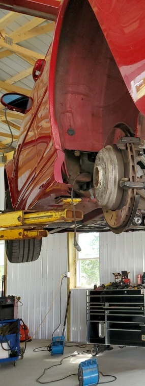

      You can also see between the actual rotor and hub, here is a picture:

          This better? Inizes

            I see both pictures fine. Look for them to be two piece and drilled. Comp rotors are drilled while regular are not. Also look between the rotor and the hub. You'll see where it is a two piece in the photo. There are little points all around connecting the two. Normal, stock one is just a solid piece of steel. There is no space to see through because the hub is also part of the same steel which ZCP is aluminum I think.

                First photo is broken on Tapatalk, works on Safari Mobile. I didn’t check on desktop. Second photo works on both.

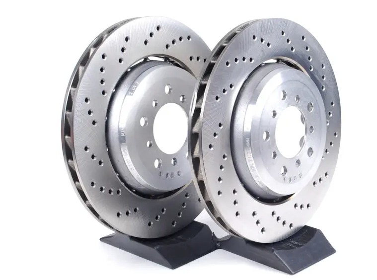

ID:	61495 Thanks everyone, for the input. I have confirmed that I have the floating rotors upfront. Same with the rears.

                      Just because they're floating doesn't mean they're the comp pack rotors-- all the euro cars came with floating rotors front and rear.
                        tl;dr; you should really just measure them to be absolutely sure.
