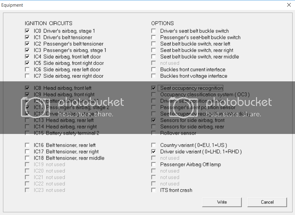

          found this online and this is where i'm curious. this part of pasoft is what we refer to as "disabling airbag lights"...but it looks to disable the functionality (ie disabling power going to those circuits) which in turn shuts off the lights, or at least thats how i'm theorizing it. disabling the circuit would mean that part of the system simply wont' work, which means my airbag is ALREADY disabled. thoughts?
