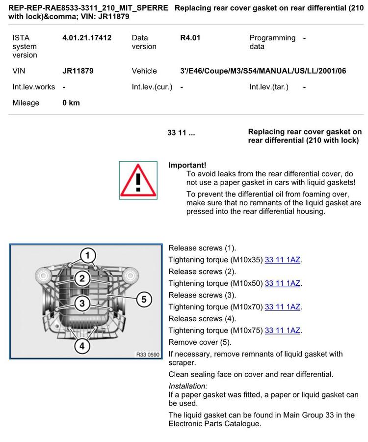

          I would follow the TIS instructions and use the bmw recommended loctite RTV and the oem gasket:

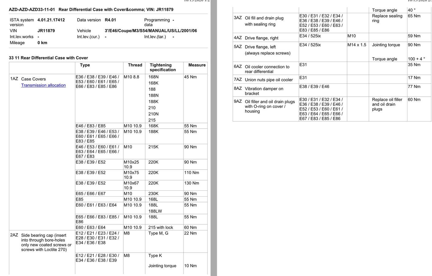

            what does the TIS say for rear diff cover replacement? Unfortunately haven't ripped a new copy of it since it went down.
              I think this is the right one. Sorry ISTA outputs as XPS and that won't let me upload it to the forum. The way I read that, it says to use one or other. I would do the RTV, I know my diff builder did but not sure if he put in the paper gasket as well.

                You can see if there is a paper gasket.

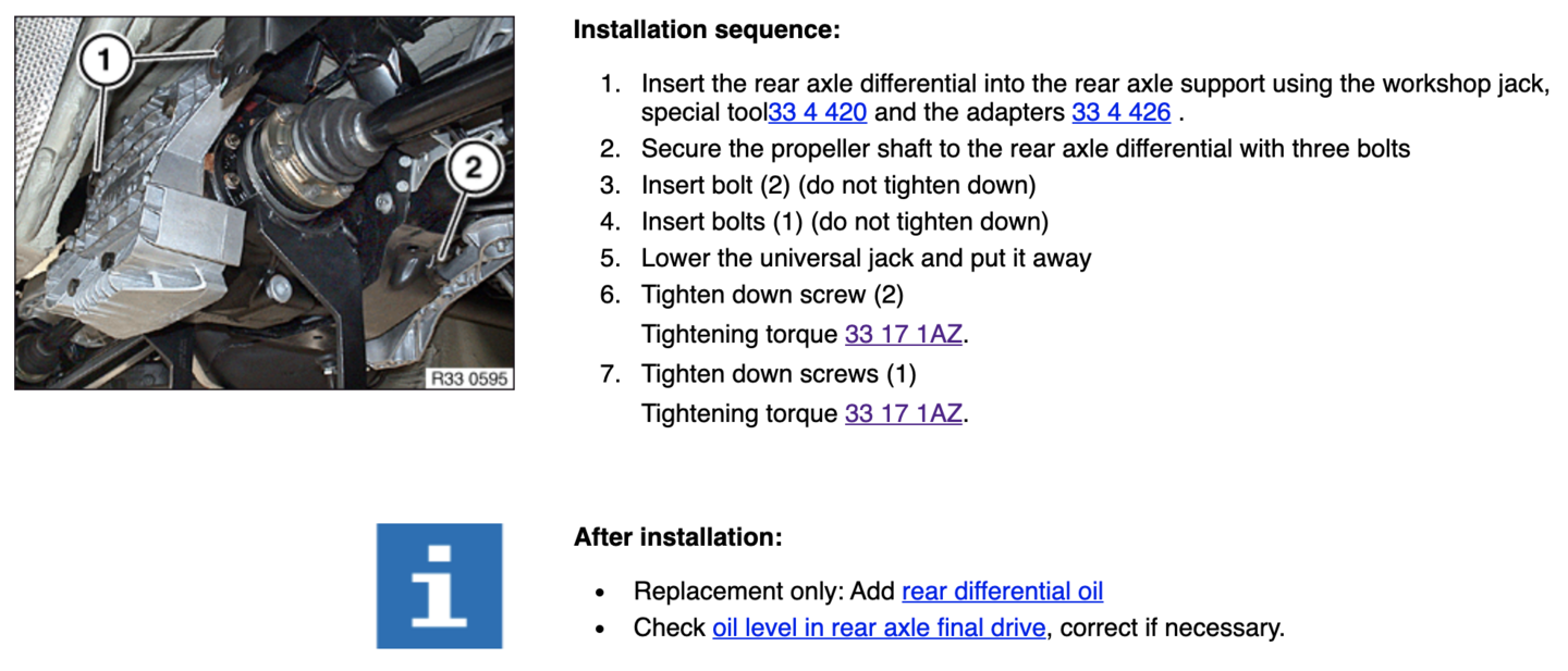

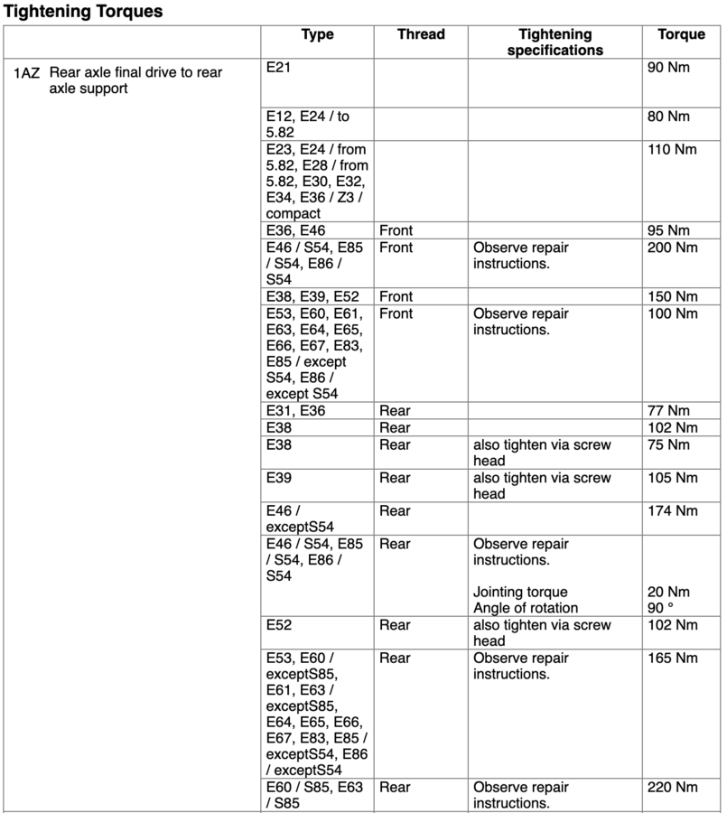

                    How about reinstallation of the diff? Any specific notes on that in TIS?

                      Yup
