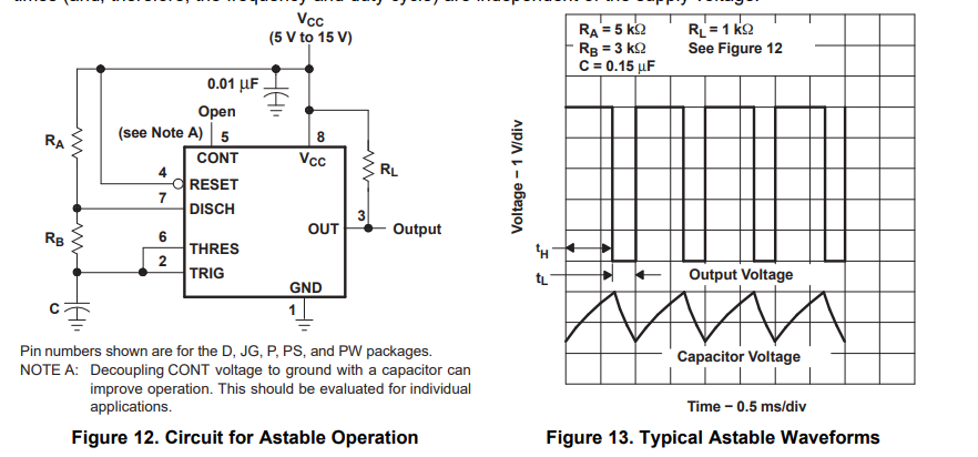

            I know this is an older thread, but was wondering if there was any new information on this that might be helpful. I am also looking at designing a circuit to power the seats when the interior lights are on or if the ignition is on, so that way they work more like the factory seats. I will post any new information as I work on this project, really excited to get these M4 seats installed.

                        I really think that would take more work and a lot more wire splicing. I have some parts on order for a circuit to pulse the Can High and the circuit would only turn on if either the interior lights are on or the ignition is on. Once that is figured out, it is on to the passenger seat occupancy sensor. I am thinking of just taking one out of an e46 seat and installing it into the M4 seat. I want to first play with one and compare it to the one that is currently installed in the M4 seat.

                            So I finally got my circuit working tonight and the seat seems to stay alive when I want them to and go to sleep when I want them to. So all I did was use a TI NE555 timmer and built the circuit that is in the datasheet for the A-stable operation. I connected a diode to ignition power and a second diode to the interior light power. Then connected the 2 diodes to the circuit power (Vcc). Lastly, I connected the CAN high to the output of the circuit thru a 0.15uF cap and grounded the CAN low. This will feed a ~1kHz to the CAN high anytime the interior lights are on or the ignition is on. Still need to get to complete the wiring in the car and install the interior back in the car so I can drive it and test the seats and circuit for real. Below is a picture of the circuit from the datasheet. Hope this helps someone, I am really excited to drive the car with the new seats. Still have a few other projects and maintenance that I need to complete first.
