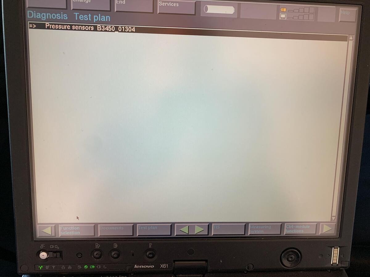

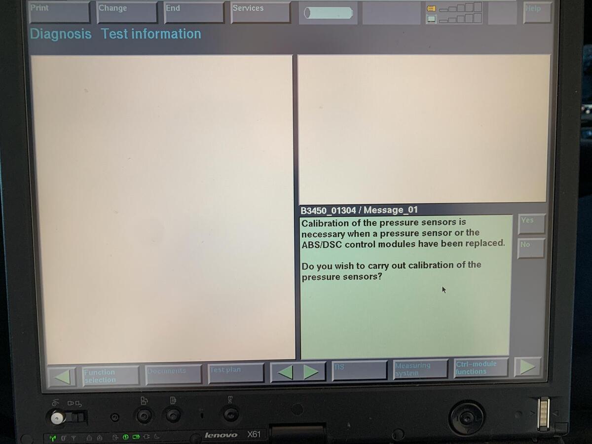

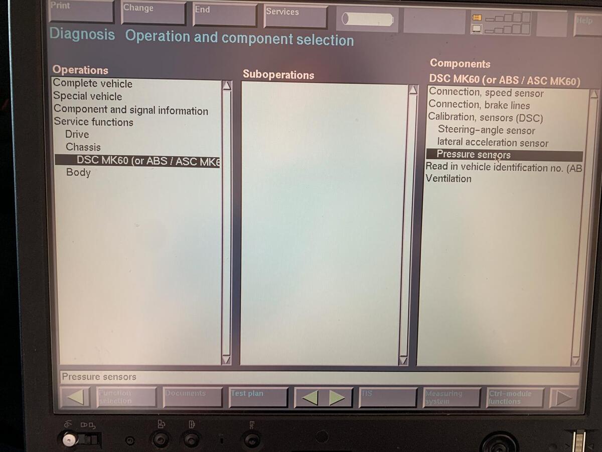

    Has anyone ever run the routine to calibrate the DSC pressure sensors? I got the DSC+Brake light today. Got code 5e24 along wit some others. When I view the live data the Front pressure sensor is like 2 bar bar lower than the rear. But pressing the pedal they seem to increase/decrease normally. I did recently tap into the brake pressure sensors for my data system, which I did on the last car and it has no effect like this.
    When you run this routine it describes it as something you run after replacing the pressure sensors. Is it safe to try to see if the pressures normalize between the two circuits?

    It resets both sensors to zero which you are suppose to do each time you replace the sensor.
    I have run it few times as it is the first thing you do before you replace the sensor to make sure it isn’t a calibration issue
        Thank you! Going to give it a shot. The car was disconnected from the battery for a long time, so maybe the calibration was lost.

          Thanks! Its not in INPA but DIS. Its also part of the foxwell scan tool.
            It’s in INPA under MK60 if I recall that correctly
              I'll check out inpa. Last time I used inpa was with an mk20.
