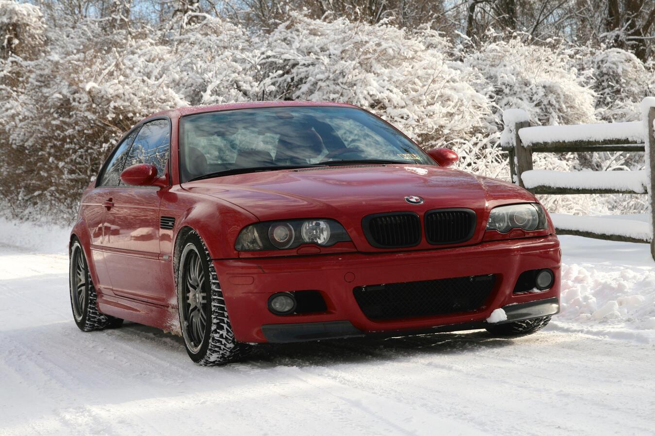

              I really miss the old (now discontinued, and replaced with an inferior tire) Dunlop wintersport M3. It was good0 in the dry, better than average in the snow, and available in stock sizes. The closest thing there has been to a no compromise snow for this car.
              Click image for larger version  Name:	IMG_6063.jpg Views:	0 Size:	197.0 KB ID:	63536
              Edit: man, current me regrets the red roundel that 15 year ago me thought was cool :P
                            Is a great photo
                            Red ❤
