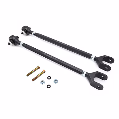

      I personally like the Bimmerworld street/track rear camber arms. Most camber arms use stock M3 rubber bushings while the Bimmerworld street/track uses OEM sealed monoball bearing which are used on CSL aluminum rear camber arms.

                    Yes, BW street/track camber arms that I linked above use CSL style monoballs. Most other camber arms either use rubber bushings or metal exposed joints.
                            https://www.bimmerworld.com/BimmerWo...Arm-Set_2.html
                            ^^ Little known detail.
                            Much like the modern shift in RTAB design (Dinan, SDW, Fall Line, etc) the sealed monoball are the best of both worlds. Last I checked CSL camber arms were NLA but they were about $700 per side before and were known to bend easily.
                            Bimmerworld and Ground Control are the only ones I know of who offer a comparable product with sealed bearing. I will probably be going with one of those unless Turner comes out with their own version...
