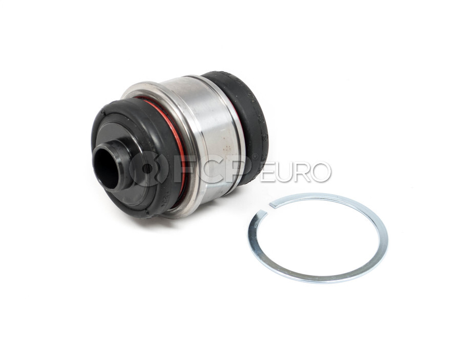

                Any idea who makes the monoball in GCs?
                I'd really like a monoball arm with a lemforder or similar quality bearing. Without even looking I'm sure BW is using a garbage bearing, because they always do. I wonder about GC...

                      Response from GC via email:
                      That is actually a bearing made to fit the 5/6/7/X series BMWs, the ones we currently have in stock are a combination of Lemforder and Delphi, I can't say for sure which ones your arms have, but it's one of those.
                        It looks a lot like this Lemforder part (33326767748):

                        RealOEM cross references to this list:
                        5' E39 (02/1995 — 12/2003)
                        5' E60 (12/2001 — 12/2009)
                        5' E60 LCI (10/2005 — 12/2009)
                        5' E61 (10/2002 — 02/2007)
                        5' E61 LCI (11/2005 — 05/2010)
                        6' E63 (05/2002 — 07/2010)
                        6' E63 LCI (04/2006 — 07/2010)
                        6' E64 (09/2002 — 07/2010)
                        6' E64 LCI (04/2006 — 07/2010)
                        7' E38 (07/1993 — 07/2001)
                        7' E65 (02/2000 — 07/2008)
                        7' E66 (06/2000 — 07/2008)
                        X5 E53 (10/1998 — 09/2006)
                        Z8 E52 (12/1998 — 07/2003)
