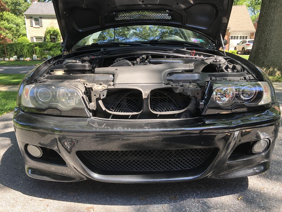

Was noticing that my headlight was a little cracked, but I decided not to replace it. Fast forward to today, I lifted the hood (there was water on the hood after the rain) and it splashed onto the air scoop. Driver side headlight stopped working shortly thereafter. First I swapped the bulbs, no go. I removed the headlight and swapped it with the passenger one, that works. Fortunately it's not the wiring. I replaced the ballasts on the headlights to check that and as I was flipping over the headlight, there was a decent amount of the aforementioned water in the lens. I opened the lens and am letting it dry out. I think the the headlight likely will be toast. Any experience with this?
Water Ingress in Headlights?
When I bought my M3 in 2014, it still had garbage angel eyes installed and the wiring created a very small but significant cut/tear in the headlamp lens gasket. I had constant condensation issues in my driver side headlamp to the point where the bulb would sometimes flicker or go out. I replaced the gaskets, lenses, and top trim on both sides this past spring via FCP. Aside from an aesthetic refresh for the lenses, I’ve had no issues since.E46 M3 Coupe - 09/04 Production, 103k miles, Black/Black, 6MT swap, AS 0% kit, BBS RG-R + AS4’s, CSL flash, Karbonius airbox, Euro header + Section 1, Koni Yellow, Xtrons, SAP Delete, lockdowns complete
