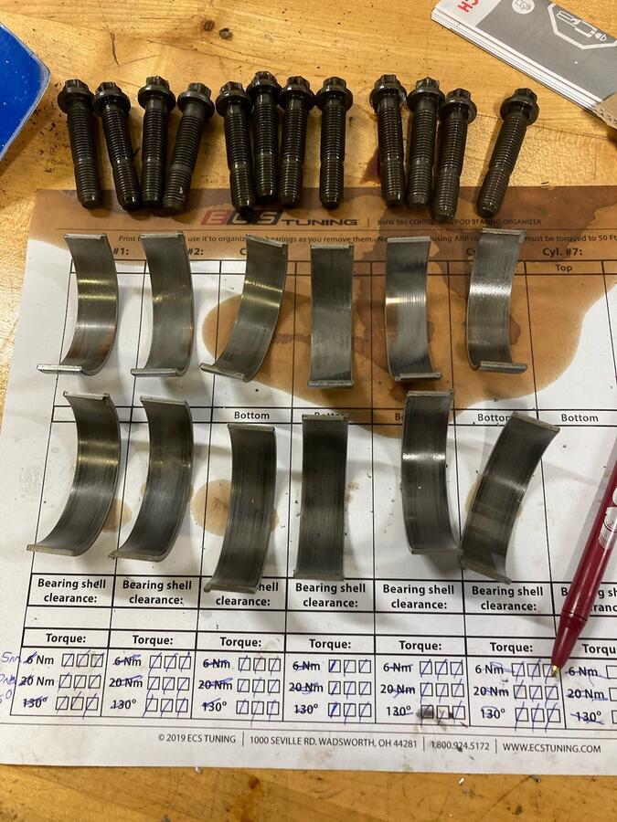

Had the rod bearings replaced ~95000 miles on the car. My M3 is Feb/03 build and never had the bearings replaced by BMW. Overall I think this was the perfect time to have them changed as copper is starting to show.

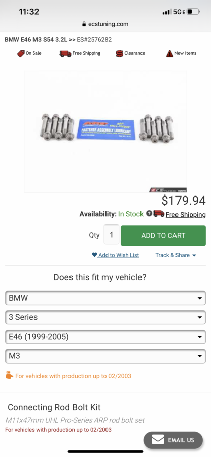

There was some confusion about the rod bolts as some places state the change was made after feb/03 and some that state Jan/03, I had bought the ARP bolts for the older version and my car actually had the newer version ( just in case someone else is in a similar situation).
