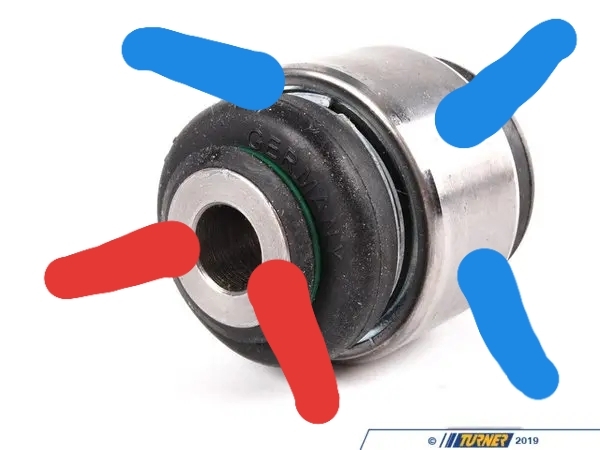

      Make sure you don't press onto the middle of the joint when installing the new ones, but instead on the outer casing (blue lines not red ones).
