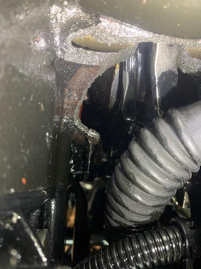

    Welp, nothing really to say other than a big resounding FAAAAAWK!! Doing a little spirited driving, rpm's skyrocketed and before I knew it boom, pulled the rod cap right off.
    In the pic you can see how the crank counterweight pushed the #2 rod right out of the side of the block, and also the exposed main oil feed galley.
    Not to mention almost lost control of the car once the engine locked-up & oil hit the tires, trying to pull off to the shoulder of the freeway. Pucker factor = 11!
    Sooooo, looks like I've got my hands full again this winter.

                Thanks guys! Yeah this was a rebuild from a few years ago, no shifter kit just SMG. Optimistically speaking, I'm hoping this only means a new block and (hopefully) repaired crankshaft. I have all the stock pistons and rods so most likely those will go back in. Obviously I'll know what I'm dealing with once I get the engine torn apart, but from what I can tell using a cheap borescope the piston didn't appear to make contact with the valves. So for now I'm calling the cylinder head good.

                          I downshifted to third at <60 mph, then full throttle while admittedly paying more attention to AFR instead of tach and that was all she wrote. I heard what must've been the cap initially being sheared off within seconds before I got the shudder, smoke and 0 on the tach.
