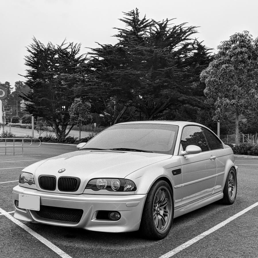

      I am running 265 on square 18" Style 67s. I can't say I've pushed the car to it's limit but have also had no trouble at all with this setup.
