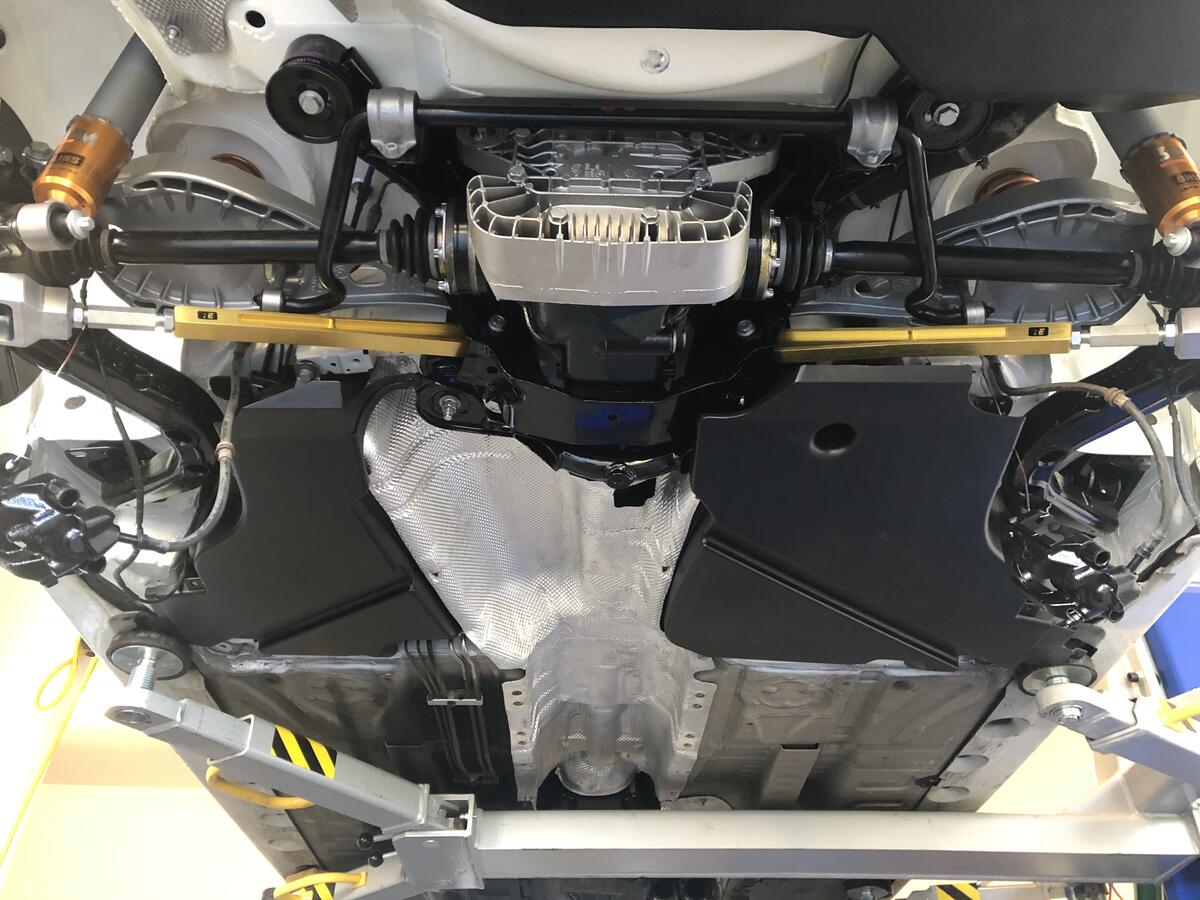

    Pic of my underside to make up for the disappointment.

    Have no knowledge regarding the noise but just wanted to say ur underside looks fantastic 👌 sooo clean
      Did you do a bunch of figure 8s in a parking lot? I've read it helps distribute the fluid all around and can stop the groaning. Haven't had the issue myself but might be worth a shot.
        Man that is a money shot, looks really clean aside from the issue..
          I would eat my dinner off of the underside of your car! So very jealous

                Thanks!! It was a labor of love. check my insta for some progress pics.

                  Yeah my undercarriage looks nothing like that. Horror show actually compared to that. Wow

                        Christ, that undercarriage is brand new. Lol that's awesome.
