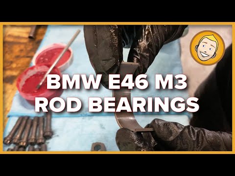

                      FWIW, I just came across this video on rod bearing replacement and once you see it, it's really not hard at all. I plan on doing mine over the winter and now have no doubts on getting it done. Being this is m3f, I mean nam3f, I'm sure there will be some comments on what they did wrong in the video j/k πŸ˜‰
                        Didn't say "bro" enough, too little talking in general, and missing retarded influencer/please watch my channel music because I'm hip. 0 out of 10, would not watch again....
