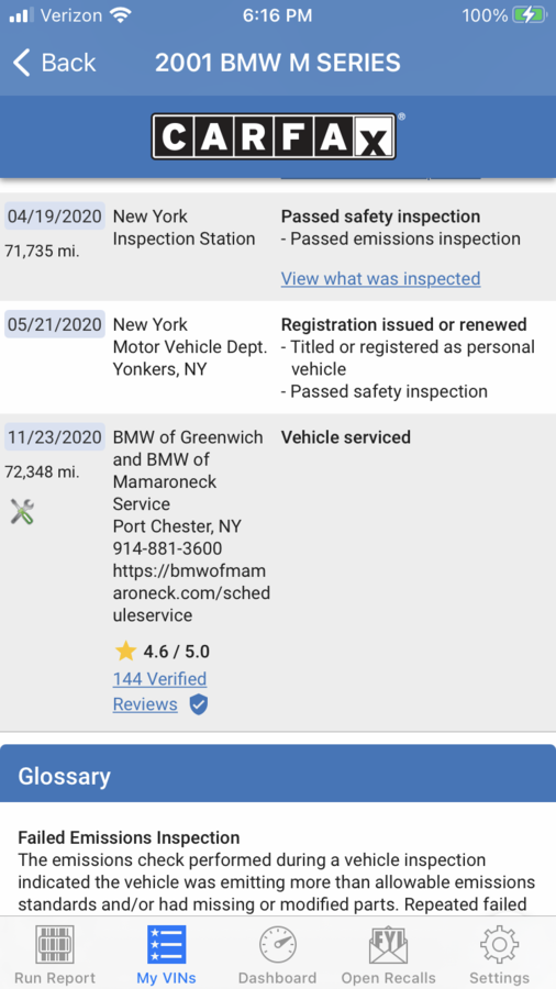

        I had the airbag recall done recently but it showed on my CARFAX as “vehicle serviced”. It doesn’t say airbags serviced but the airbag recall needed was removed off the report.
