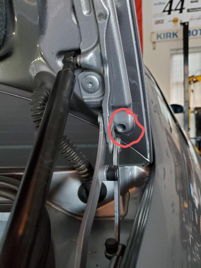

    I noticed on the stock trunk there are holes in the same spot as the hole pictured below on my OE CSL trunk. The holes on the stock trunk are about half the size but have rubber plugs in them.
    Simple question, should these holes on the CSL trunk be plugged? I figured they were drain holes until I saw them plugged on the stock trunk.

    Typically trunks don't have drain holes or vents, the drain is done on the outside of the trunk to allow water to flow around the trunk . If water was able to get inside the trunk lid it would rust overtime. Haven't dealt with this yet but personally I would plug it.
    Sent from my SM-G955U1 using Tapatalk
      You know, i was thinking the same thing lol

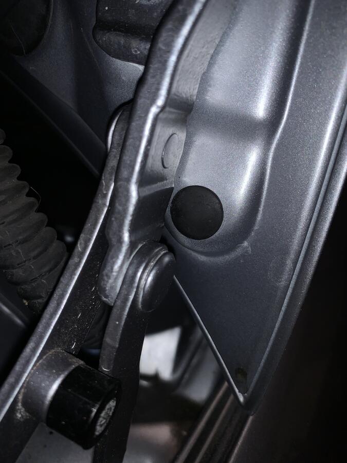

        They are plugged on the CSL
        I’ll get you a part number later.

                  should be part 51718110199

                        Is this just one plug on each side of the trunk?
                          Yeah
