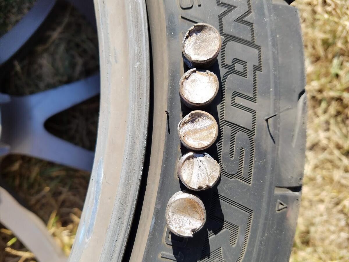

            Viewed very closely (I was there), the studs on the E93 M3 had micro cracks on most of the failed studs that had rust slowly developing inside the studs. The owner had all brake and tire work done in shops and seldom worked them himself. I don't see any explanation other than impact wrenches beating on them to unknown torque.
