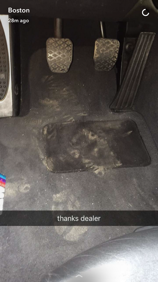

    Here’s a picture of last time at the dealer. The floor mats and pedals were CLEAN. Now look at all the dirt haha

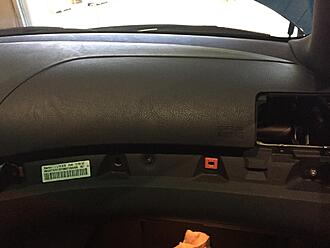

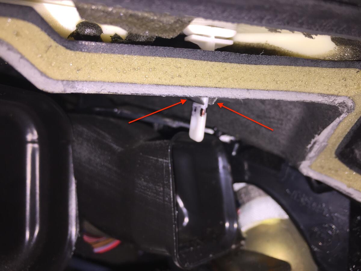

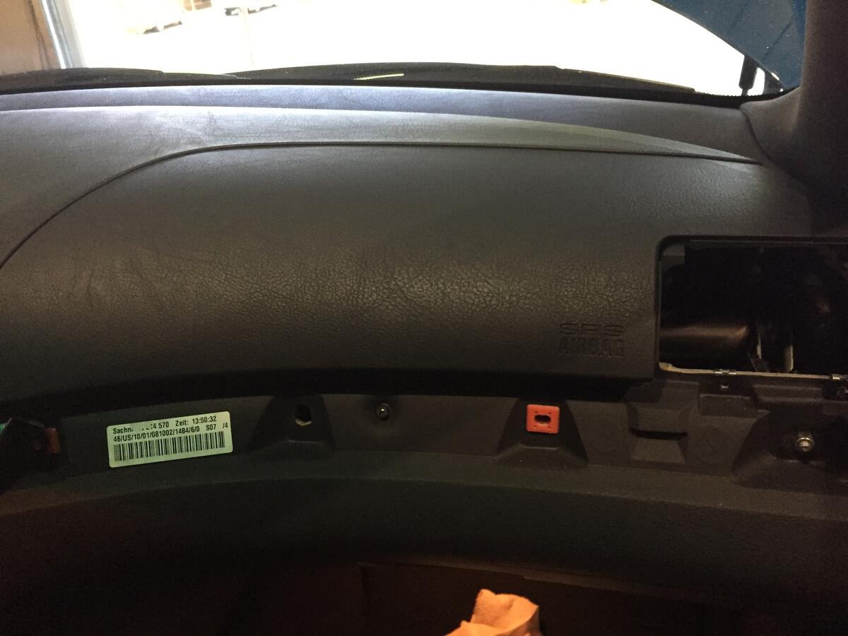

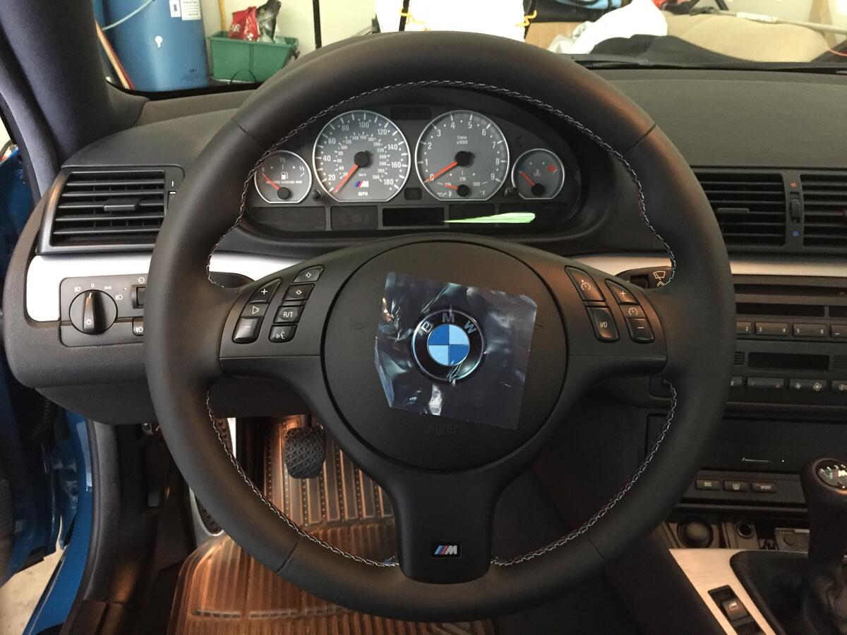

              If you really want to ensure you minimize damage, and you're good with working on cars, remove them yourself (just don't turn the car on afterwards or it will trigger the ABS light and I can't say if they'll reset the light for you for free).
              -Remove RH dash trim as stated above
              -Remove RH vent (phillips)
              -Remove screws behind dash trim (phillips)
              -If you're really careful, as I was you can spread the metal clip (shown in photo) to carefully remove the "non-reusable" retaining clip that breaks when the passenger airbag is deployed. I marked mine before I removed it so the airbag cover wouldn't sit too high or low in the dash upon reinstallation.
              I did all this without removing the airbag prior to driving to the dealer. Then when I got there, I popped out the driver's side airbag to make it ready for removal since that's something you can do anywhere.
